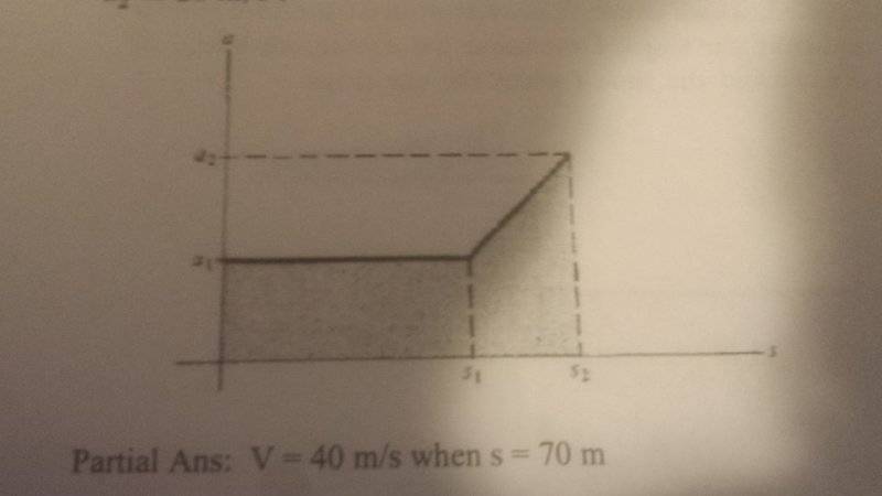

The a-s graph for a rocket moving along a straight horizontal track has been experimentally determined. If the rocket starts from rest, determine its speed at the instants s = 20m, 50m, and 70m, respectively. On the graph, S1 = 50m, a1 = 10 m/s^2, S2 = 70m, and a2 = 20 m/s^2
ads = vdv [/B]
I know that the solution for the velocity at S2 = 70m is V = 40 m/s, but I'm not sure how to get there.
I know we talked about the relationship for ads = vdv so I tried taking the integral on both sides to calculate for the velocity.
I tried to solve for the velocity at S2
The integral from 0 to v of vdv = the integral from 0 to 20 of ads
So, V^2/2 = 20s which means V^2 = 40s where S = 70 meters.
So I get V = √(40)(70) = 52.9, which is not correct.
Any help would be much appreciated!
What is the graphical way to interpret the integral of ads from s = 0 to s = 70 m?
My best guess is the area of that section from 0 to 70? Is that in the right direction?
Yes.
Okay, so I got 800 for the total area underneath, but I'm not sure what the next step is
Good.
How is the integral of ads related to the integral of vdv?
They're equal to each other? So I could set v^2/2 = 800 which in the end makes v = 40.
Did I think about that correctly?
Yes.
