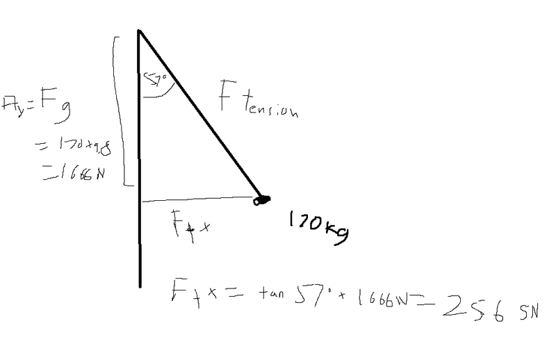

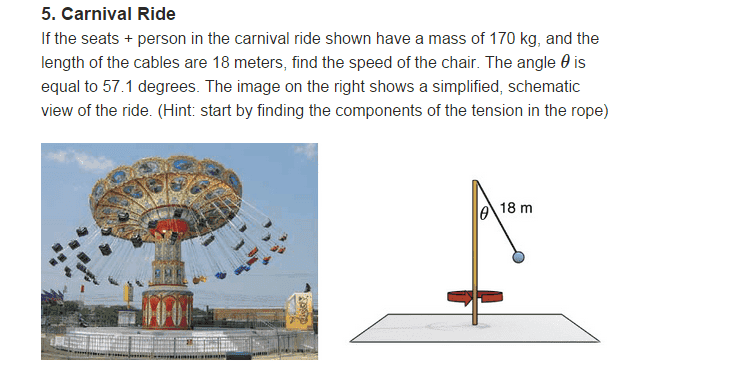

F = m v^2 /r
so find the components of the length of the rope, the X component is 15.11m and the Y component is 9.77m.
15.11 should be the radius of the circle if you look at it from above.
the components of Fg should be Fgx = 1398 N and Fgy = 904 N
Plugging into Fcentripetal = mv^2/r = 170kg x V^2 / 15.11 = 1398 N
V should equal 11 m/s.
can someone confirm if this is correct?

I have to keep in mind that we only use the X component of tension in our equation : Ftx = mv^2/r
Can you provide the FBD?
goonking said:
what do I use tan delta for? to find tension of the rope?
apparently, mass was required in my equation, but can you show your way that didn't require mass?
If you have the FBD , i can tell you, Hint: it's not for the tension,
The angle made depends only on the velocity(and g). Please draw the FBD , everything will get sorted out.

goonking said:
using 2565 N as the X component of tension.
2565 = 170kg v^2 / 15.11m
V = 15.1 m/s

Was it correct to set FTy = Fg = 9.8 x 170kg?
goonking said:
did you obtain 2565N the same way I did?
i used ##\theta##=57.1° so i got 2575N
yes.
... I think the place you'd lose marks here is that the reasoning behind how you arrived at that figure is not all that clear ... I see it's Fty.tan(θ) but why would you know to do that? What was the physics behind that decision? I cannot tell from what you wrote.
hmmm. didn't think you can set FTx = 1/2 m v^2 but I'll try to remember
... this suggests that you did not get the figure the same way that Suraj did.
Do you understand why what you did got the correct answer?
Since you put in a lot of work, I'll walk you through what I mean:
The FBD should be a blob (for the mass - label it "m") with an arrow pointing directly down labelled "mg", and arrow pointing up and to one side labelled "F_T" (tension) and a vertical dotted line, the angle between the tension and the dotted line is drawn in and labelled "theta".
It is best practice to do as much algebra as possible with variables and plug the numbers in at the end.
Using ##\sum F=ma## vertically and radially off the FBD...
(1) vertical: ##F_T\cos\theta - mg = 0##
(2) horizontal: $$F_T\sin\theta = \left[ ma_{centripetal} = \frac{mv^2}{r} = \frac{mv^2}{L\sin\theta}\right]$$ ... this gives two equations with two unknowns.
Solve for the tension force in (1)...
$$F_T = \frac{mg}{\cos\theta}$$
... then sub into (2)
$$mg\tan\theta = \frac{mv^2}{L\sin\theta} $$... solve for v (L is the length of the cables: notice how the mass cancels out?): $$v=\pm\sqrt{ gL\tan\theta\sin\theta }$$
L=18m, g=9.8N/kg, θ=57deg ... plug the numbers into the equation gives v= 15.1m/s ... well done.
What I'd like you to notice is how the above approach is easier to read and troubleshoot - it is also easier to award full marks to.
Always make it easy for the marker to give you more marks.
It is often useful (and worth bonus marks) to reflect on the result. i.e. is 15m/s a fast speed to travel?
Compare with typical road speeds where you live.
