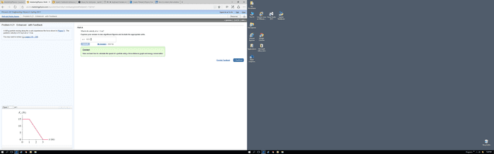

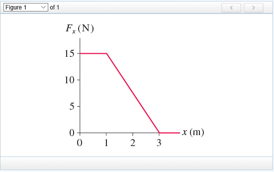

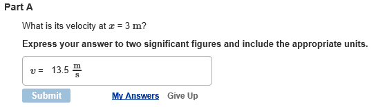

W= \integral(Fxdx) W = \delta KE
I used the definition of work to find the final velocity at 2m, and then work theorem together with integration for the changing force. I ended up having different solutions at first but then attempted to find acceleration instead for the constant force, and then plugged into find time it took it to reach 2m.
Then I used that data to find final velocity at 3m. It turned out very well. I just didn't understand why my first solution was wrong,
If you show us exactly what you did and how you calculated your first solution, we should be able to help you.
I found out the error! I copied the graph wrongly so when I plugged in for integration, it was off! Jesus! Thanks though. Next time, I will post my handwritten note!
