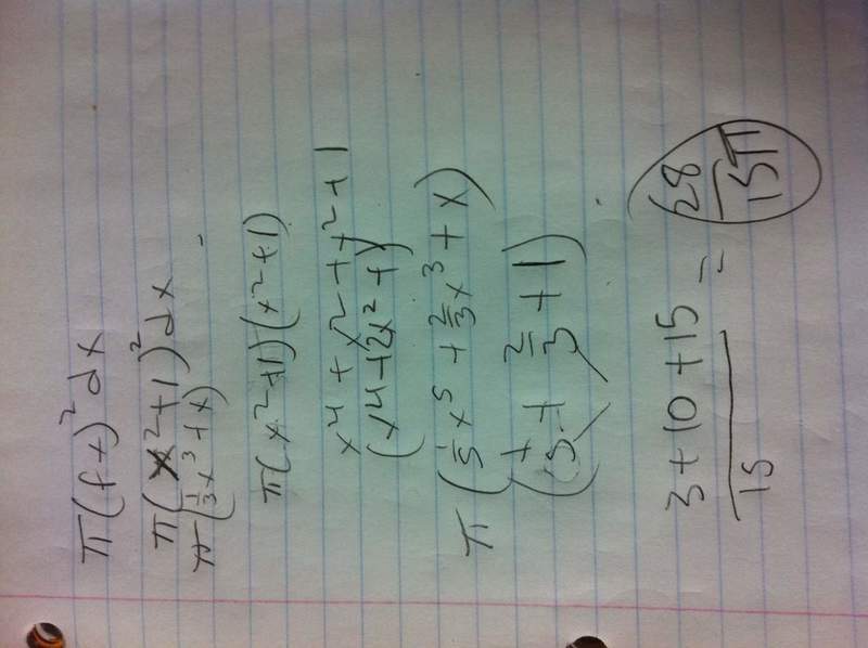

y=x^2+1
X in (0,1)
formula needed
integral (PI [f(x)]^2 DX
in the F(x) just plug in the equation right?
took anti deritive of the original problem and came out with
PI[1/3x^3+X]^2
my answer is 5.58
am i on the right track?
im confused on the squared part. Do i take the Anti deritive of the squared or only the thing inside the brackets?
Right, you plug f(x) into the formula, but that ^2 means you square f(x), so [f(x)]^2 = (x^2 + 1)^2. That's what you actually want to integrate.

So how do i take the Anti deritive of that?
is it 1/3(x^2+1)^3*(1/3x^3+X)^2? I am going blank lol should there be a ^2 at the end of that?
That wouldn't be the way to integrate it
Easiest way would probably be to multiply it out,
(x2+1)2 = (x2+1)(x2+1) = ...
then integrate each term.

Got it!
does this look right? excuse my chicken scratch handwriting.
Yep, that's it!
