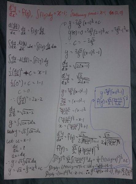

A function of y, ##f(y)##, is known to be equal to the second derivative of function ##y(x)##. ( i.e. ##\frac{d^2y}{dx^2}=f\left(y\right)## )
Given that ##\int _{ }^{ }f\left(y\right)dy=x-1##, and function ##y(x)## has a stationary point at ##x=1## and an x-intercept at ##x=2##, find ##y(x)## and hence find ##f(y)##
Knowledge of solving differential equations.
##∴ \int _{ }^{ }\frac{d^2y}{dx^2}dy=\int _{ }^{ }\frac{d\left(\frac{dy}{dx}\right)}{dx}dy=x-1##
I derived both sides with respect to ##y##
##\frac{d\left(\frac{dy}{dx}\right)}{dx}=\frac{d\left(x-1\right)}{dy}##
And this is where I get stuck. I'm not sure what to do from here, can someone please help? Thank you.
In
\int _{ }^{ }\frac{d\left(\frac{dy}{dx}\right)}{dx}dy = \int \frac{dy}{dx} d\left(\frac{dy}{dx}\right)
if you write ##dy/dx = v##, can you do the integral analytically?
blue_leaf77 said:
In
Ah yes I see what you're saying. Integrating a function (or in this case a derivative function) with respect to itself is the same as integrating a singular variable with respect to itself. I've done some quick working out and this is what I got:
Do you think this looks right or am I way off track?
If you check the consistency of your final result with the properties it should have as given in the problem, I guess then your answer is right.
