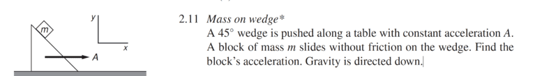

Find the blocks acceleration on a wedge.
F=MA
I am currently solving this problem and approached it two different ways. I have attached a ss of the picture for reference.
On my first attempt, shown on the attached image in pen, I used a component of the normal force and weight as my forces in the y direction. I carried out the work and ended up getting the correct answer according to my book.
I then tried a different approach, as shown by the image with the whiteboard, and used the actual normal force and a component of the force of gravity. When I used this approach I got stuck and did not see anyway of attaining the correct answer.
What is incorrect about the 2nd approach that is preventing me from getting the right answer?
