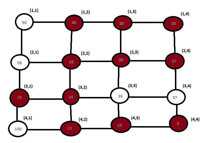

I tried to make an example:View attachment 4370So we go only through the vertices of the form $(i,i), (j,j+1)$ and $(k,k-1)$, right? (Thinking)
Sorry, I don't understand. (Doh)
Can you explain it further? (Wondering)

I noticed that we will not visit all the nodes, but only the ones of the form $(i,i), (j,j-1), (k,k+1), i,j,k \in \mathbb{N}$..
Isn't it like that?
If so, do we find the time complexity, using this fact? (Thinking)
Isn't it like that?
Suppose we want the path to be (1,1) - (1,2) - (1,3) - (1,4) - (2,4) - (3,4) - (4,4) - (4,3) - (4,2) - (3,2).
Can we find grid values so that this path will be taken? (Wondering)

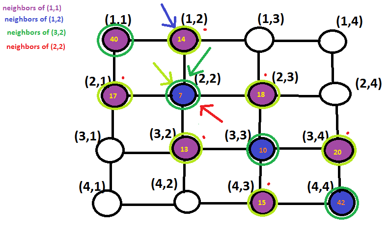

I thought that after a node of the form $(i,i)$, only a node of the form $(j,j-1)$ or $(j,j+1)$ can follow.
For example, in this case:View attachment 4373
the neighbor of $(1,1)$ with the smallest $y_w$ is $(1,2)$ and then the neighbors of $(1,2)$ will be $(1,1), (2,2), (3,3), (4,4)$ and from these the node with the smallest $y_w$ is $(2,2)$.
Am I wrong? (Thinking)

Also, I found a graph at which we go through all the vertices, in order to find the local minimum:View attachment 4374Or have I done something wrong and it isn't like that? (Thinking)
Good! (Smile)
Note that we're not moving through all the vertices, but all vertices do get examined.
Actually, we move through $\frac 12 m^2$ vertices, and at each step we examine $2-4$ neighbors.
That makes it indeed $\Theta(m^2)$. (Mmm)

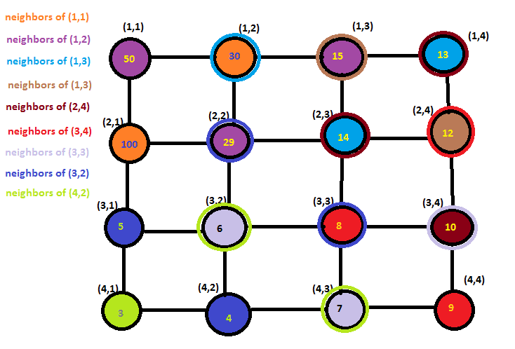

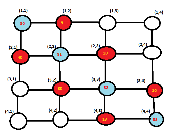

At the following graph, the most of the vertices are sorted and we move through $11=O(4^2)$ vertices, or not? (Thinking)

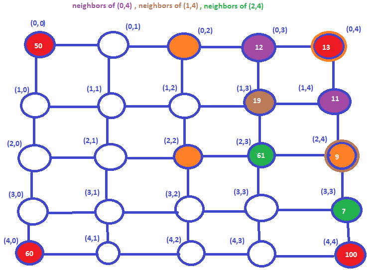

How can we be sure that the local minimum is in the subgraph with corners $(0,2), (0,4), (2,2), (2,4)$? At the above graph, the local minimum is $(3,3)$, that is not in this subgraph (assuming that its neighbors have no smaller values).. Or am I wrong? (Worried)
I think we would only move through 5 vertices before we stop. (Sweating)
But we can get to a path that looks like:
[TEXTDRAW]xxxxxxxxxxxxxxxxxxxx
x
x
x
x
x
xxxxxxxxxxxxxxxxxxxx[/TEXTDRAW]
(Wasntme)
You are right. It won't work. (Worried)
