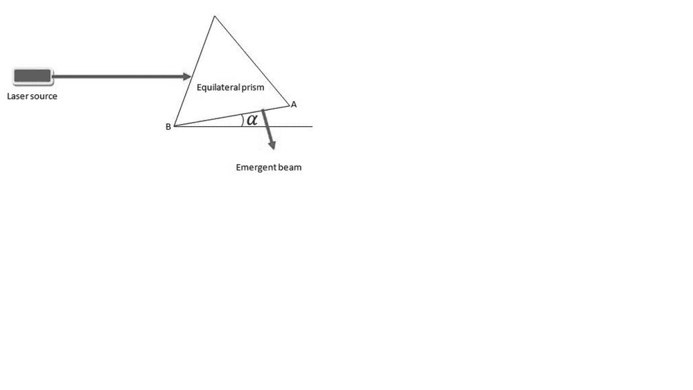

A light beam from a laser source which is parallel to a horizontal surface hits an equilateral prism as shown in the figure above. What is the angle α (between AB and horizontal) if the emergent beam is perpendicular to face AB? (refractive index of prism is 2)
a. 42.5 degree
b. 24.5 degree
c. 15.0 degree
d. 46.0 degree
e. 30.0 degree
Snell's law
Total internal reflection

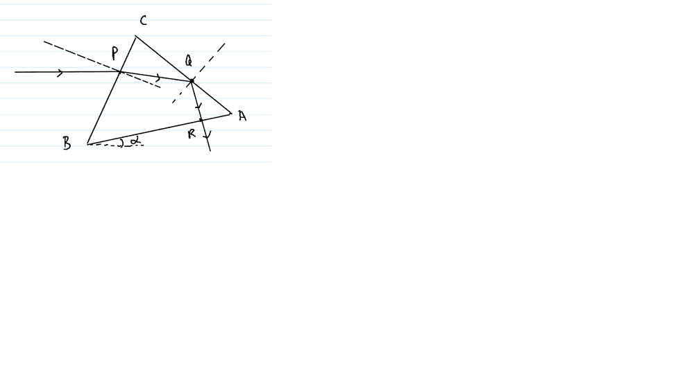

This is my sketch:
I think the only possible way to get emergent beam perpendicular to AB is when the incoming ray is refracted towards side AC then total internal reflection occurs as shown in my sketch.
Angle QAR = 60o and angle ARQ = 90o so angle AQR = 30o
It means angle CQP is also 30o so angle QPC = 90o, which is impossible
Where is my mistake? Thanks
The diagram shows the ray emerging from AB, but the text does not say that.
Is that diagram as given to you, or did you make that assumption?

... so angle QPC = 90o, which is impossible
Why is this impossible?
Likes songoku and jbriggs444
The question states : " if the emergent beam is perpendicular to face AB".
The first diagram is from question, the second is my own sketch
Because it means that the angle of refraction when the lights travels from air to prism is zero degree, which can only be obtain if angle of incidence is also zero degree.
Or are you suggesting that actually the incident ray is perpendicular to side BC so this means that the prism is tilted as far as 30o?
Thanks
Yes, but that is just a direction. It does not say it emerges from that face.
songoku said:
The first diagram is from question.
Ok, so it does emerge from that face, in which case...
which is indeed one of the options.
