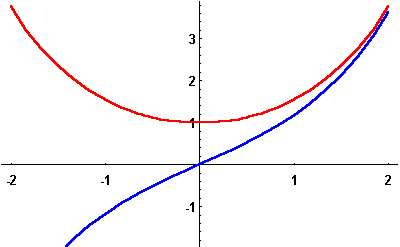

Right you are!
I had that ##e^{\xi} - e^{-\xi} = 2 \cosh{\xi}##—which would imply the only way ##\chi(1)=0## is if ##E = 0## since ##\cosh{x}\not=0## for any ##x##—when instead, ##e^{\xi} - e^{-\xi} = 2 \sinh{\xi} \implies e^{\kappa x} - e^{-\kappa x} = 2 \sinh{\kappa x}##, so [tex]\chi(x) = 2E \sinh{\kappa x}[/tex] which means [tex] \chi(1) = 2E\sinh{\kappa} = 0[/tex] which is only true for either ##E = 0## (trivial) or for ##\kappa = 0##.
Fig 1.
Blue line is ##\sinh{x}##; red line is ##\cosh{x}##.​
Does this look like a good place to continue from? The implications of ##\kappa = 0## on ##\gamma(y)## also worries me.
No, you are not using the actual form you wrote down for the solution in the x-direction. Also remember that you must check all values of ##\kappa##.
There is also an error in your solution, the argument of the functions is not ##\kappa x##, this would give ##\kappa^2## as a factor when differentiating twoce instead of ##\kappa##, which is in your differential equations.

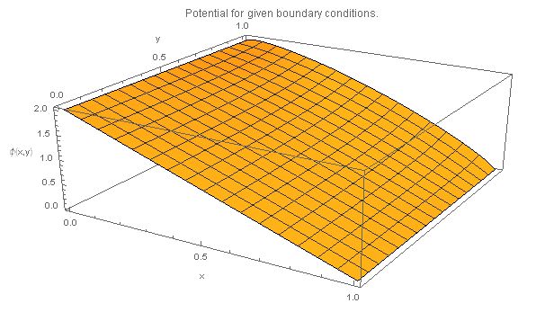

Solution:
For anyone reading this who is interested in the solution:
Applying the new homogeneous boundary conditions in ##x##:
  1. ##\Delta\phi(0,y) = 0 \implies \boxed{F = 0};##
  2. ##\Delta\phi(1,y) = 0 \implies \boxed{\kappa = n \pi}## for ##n\in\mathbb{N}##.
means that \begin{equation} \chi(x) = E \sin{n\pi x}.\end{equation} We can hence determine ##G## and ##H## using the original boundary conditions 3 and 4. 3 finds that ##\boxed{A = -B}##, so \begin{equation}\gamma(y) = A\sinh{n\pi y}.\end{equation} Hence, using the separable solution and summing over all possible (infinite) solutions, we find that \begin{equation}\label{eq:phisol} \boxed{\boxed{ \Delta\phi(x,y) = \lim_{M\rightarrow\infty} \sum_{n=1}^{M} c_n\,\sin{n\pi x}\, \sinh{n\pi y} }},\end{equation} where ##c_n \equiv A_nE_n## and ##M## is simply included for a computational application.
Now, we use 4 to calculate the ##c_n## coefficient. We differentiate \ref{eq:phisol}, apply Fourier's trick (as David J. Griffiths calls it) and hence find that \begin{equation} \label{eq:cnsol} \boxed{ \boxed{ c_n = \frac{ 2 (1 - \cos{ n \pi }) }{ ( n \pi )^2 \cosh{ n \pi } } } }.\end{equation}
Using this solutions, we find that for ##M = 20##, the potential looks like the attached graph.
