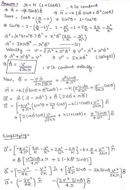

A particle moves with constant velocity v along the curve r = k(1+cosθ) (a cardioid), where
k is a constant. Find the acceleration of the particle (a), a· rˆ, |a|, and θ˙.
a = dV/dt
I am trying to follow the solution to the following problem, both linked in the attachment.
When trying to find the acceleration, a, that should be taking the derivative of r, the position formula twice. When doing so I get v = -ksinθ and a = -kcosθ. The attached work shows v being -(ksinθ)θ' which also leads to them getting a different answer for acceleration. Am i approaching this problem the wrong way?

quittingthecult said:
Homework Statement:: A particle moves with constant velocity v along the curve r = k(1+cosθ) (a cardioid), where
Relevant Equations:: a = dV/dt
To find the velocity and acceleration you need to differentiate twice with respect to time. You appear to have differentiated wrt ##\theta##. Using the chain rule, you must then multiply by the derivative of that wrt time.
Since I am differentiating with respect to time, this becomes implicit differentiation?
Yes, which is just an example of the chain rule.
