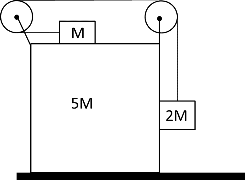

What is the initial acceleration of mass 5M .The pulleys are ideal and the string inextensible.
My attempt-
2Mg-T=2Ma (for 2M)
T=Ma (for M)
Solving we get T=2Mg/3
T-N=5MA (for 5M)
N=2MA (for 2M)
Solving we get A=2g/21
but the given ans. is 2g/23
Draw some diagrams. Which direction will mass 5 be moving? How much mass is it moving in that direction?

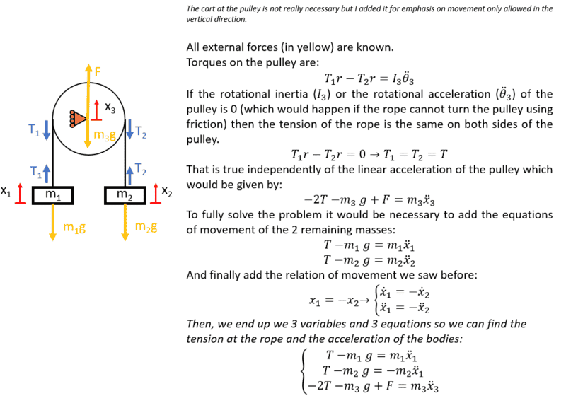

I misunderstood what you meant. I thought you were talking about the rotation of the pulleys, not their linear movement.
However, I still cannot agree with you. Even if the pulley is linearly accelerating because it is part of the body 5M, the x movement of M (top block) will be the same as the y movement of 2M (vertical block) because the length of the string is fixed. Then, if the pulleys are massless or frictionless (the point is they don't contribute through rotation) the tension of the string will be the same on both sides.

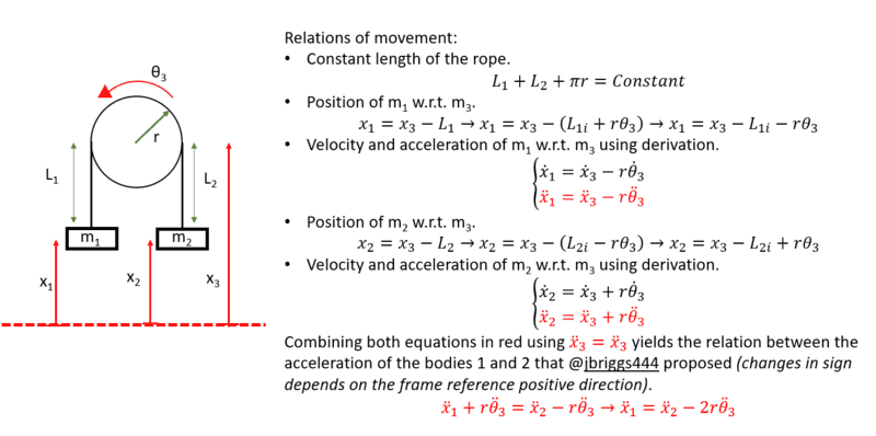

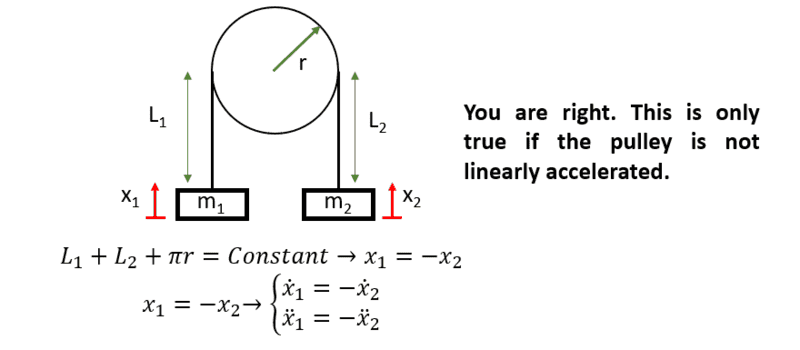

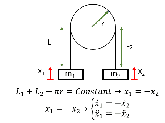

As an example of what I mean, see the following:
The length of the string is independent of the acceleration of the bodies so the relation must stay true whether any of the bodies are accelerating or not.
If still in doubt, let's see the problem with forces being involved and the pulley being able to accelerate. External forces are shown in orange (weight and force on the pulley) and internal forces are in blue (tension in the strings).
TO SUM UP, in the problem from OP and the one I'm showing the tension is the same on both sides of the pulley as long as the pulley has no rotational inertia or it is not rotating at all (rope sliding without friction over it). Also, the movement of one block will be the same as the other in the axial direction of the rope.
If the pulley had rotational inertia it would be necessary to add how its angle relates to the position of the blocks. All the relevant independent equations are shown in the following picture:
See how I didn't use accelerated frames at any point. To be honest, I think there is no point on doing so. They add no insight and just make everything more confusing in my opinion.
We agree that the tension throughout the string is the same. That much is not in question.
The length of the string is fixed independent of the acceleration of the bodies. We agree on this as well.
However, your diagram here is a good one. You would say, I am sure, that the upward acceleration of ##m_1## here is equal to the downward acceleration of ##m_2##. Right?
But if the pulley is accelerating upward then this is no longer the case.
Instead, if the upward acceleration of the pulley is ##a_p##, the upward acceleration of ##m_1## is ##a_1## and the downward acceleration of ##m_2## is ##a_2## then can you agree that the rate that the string is shortening on the left hand side is ##a_1 - a_p## and the rate that the string is lengthening on the right hand side is ##a_2 + a_p##?
Setting those equal, we have ##a_1 = a_2 + 2a_p##. The acceleration of the pulley matters!

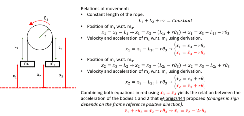

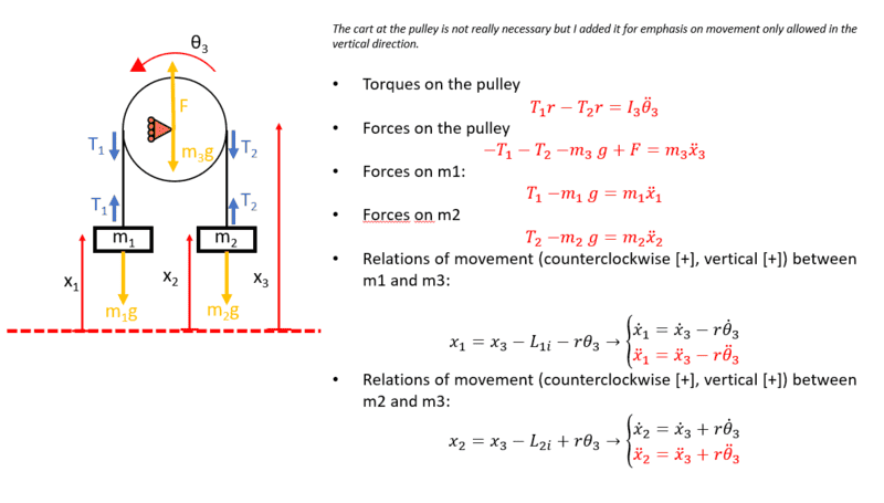

I reviewed the problem and you are right. The accelerations of the two bodies are not necessarily the same since it depends on the linear acceleration of the pulley too.
I needed to plot the diagram again to fully understand the situation and this is what I got. For clarity's sake, I defined a global inertial frame positioned lower than all the bodies.
Therefore, the example I proposed would be solved with the 6 following equations that allow us to calculate the 6 variables ##T_1, T_2, \ddot{x}_1, \ddot{x}_2, \ddot{x}_3, \ddot{\theta }_3##:
NOTE: The problem could be simplified by assuming the pulley doesn't have rotational inertia or that its angular acceleration is 0 because there is no friction with the rope so it will simply slide over it.

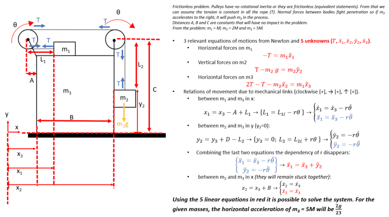

I believe I was initially wrong as discussed in this message. @jbriggs444 was right in calling out my mistake.
But it's true that the problem can be solved using both inertial and non-inertial frames.
Now, going back to OP's initial post, I solved the problem again following the same procedure as with the example I provided with an inertial frame, and this time I did get that the acceleration of the 5M body will be ##a_{5M} =\frac{2g}{23}##.

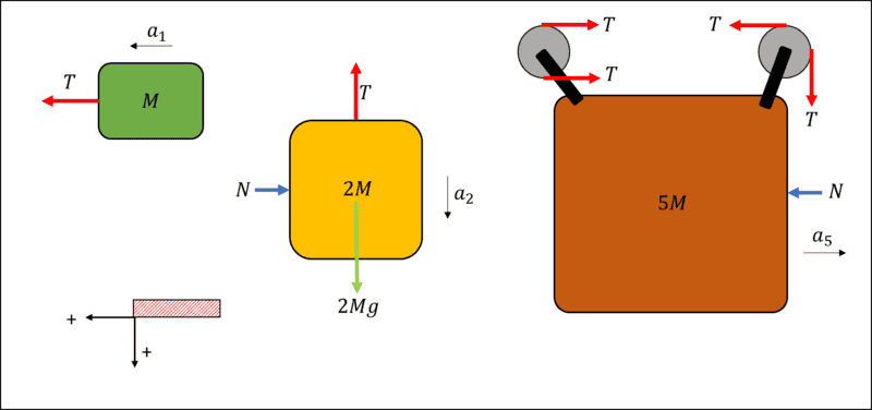

Just to show some more steps:
The global frame of reference is fixed to the ground, and the FBD's show forces relevant to solving the problem.
Horizontal Direction for Block 1M
$$ T = M( a_1 - a_5) \tag{1}$$
Edit: ##a_1## is w.r.t the block 5M.
Vertical Direction for Block 2M:
$$ \begin{aligned} 2Mg - T &= 2Ma_2 \\ & \implies T = 2M(g-a_2) \quad\quad \text{(2)} \end{aligned}$$Given a positive acceleration ##a_2## will result in a positive acceleration ##a_1##, hence ##a_2 = a_1##, combine (1) and (2) with the constraint:
$$ \begin{aligned} M( a_1 -a_5) &=2M(g-a_2) \\ &= 2M(g-a_1) \\ & \implies a_1 = \frac{2g+a_5}{3} \quad\quad \text{(3)} \end{aligned}$$Horizontal Direction of Block 2M:
$$ \begin{aligned} -N &= -2Ma_5 \\ & \implies N = 2Ma_5 \quad\quad \text{(4)} \end{aligned}$$Horizontal Direction of Block 5M:
$$ \begin{aligned} T -2T + N &= -5Ma_5 \\ -T + N &= -5Ma_5\quad\quad \text{(5)} \end{aligned} $$
Combine (4) and (5) (substituting for N) to yield:
$$T = 7Ma_5 \tag{6}$$
Lastly combine (1) , (3) and (6) to eliminate ##T## and ##a_1##:
$$ \begin{aligned} \cancel{M}(a_1-a_5) = 7\cancel{M}a_5 \\ \frac{2g+a_5}{3} - a_5 = 7a_5 \\ & \implies a5 = \frac{2}{23}g \end{aligned}$$
I initially kept getting the wrong answer until realized that I had assumed a negative acceleration for block 5M in the horizontal force balance for block 1M. As a result, I needed to keep that assumption throughout the analysis (hence the negative signs on the RHS of (4) and (5) become important). Anyhow, thought I would share my trials and tribulations in case others were having the same difficulty there.

It is important to mention that ##a_1## is the acceleration of block M relative to block 5M.
I’m not sure it is? If the block 5M was fixed ## a_5 =0## the equations 1 and 2 reduce to ##a_1 = 2/3g##. That’s w.r.t. to the inertial frame. To me the quantity ##( a_1-a_5)## is the acceleration of block 1 w.r.t. the inertial frame. Maybe I’m under thinking it.
That’s correct. Isn’t that consistent with my comment?
Yeah, I think it is. I was under thinking it. ##a_1## is not with respect to the inertial frame, it’s relative to a fixed position on block 5M as you suggest.
I let a be the vertically down acceleration of 2M and a' be the acceleration to the right of 5M (and thus of 2M). T is the tension.
##2Ma'=2Mg-T##
M accelerates at a to the left relative to 5M:
##M(a'-a)=T##
Considering the horizontal forces on the 5M+2M+pulleys system:
##7Ma=T## ( the two Ts from the top string cancel).
Easy from there.
