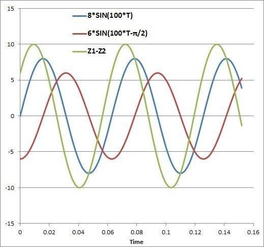

so there is this problem : find the amplitude from the superposition of Z1 and Z2 where
Z1 : 8 sin 100t, A1= 8m
and Z2 : 6 sin (100t-pi/2), A2=6m
i know that all we need to do is add them and do the trig using sine additon, but i couldn't do that because the amplitude is different.
yeah they give me the key answer but i don't understand because the solution only stated that all you need to do was do pythagorean theorem based on each amplitude.
$$ \sin(100t-\pi/2) + \cos(100t) = ? $$

i change the second wave function (Z2) from 6sin(100t-pi/2) to -6cos(100t), so i have this problem :
8sin(100t) - 6cos(100t), and i got stuck right there.
Energy conservation: $$ A_{12}^2 = A_1^2 + A_2^2 $$ because there are orthogonal.

You have to write 8 sin(100t)-6cos(100t)in the form A sin(100t + Φ ) where Φ is the phase constant. You can expand it, applying the addition rule for sine. What do you get?
The equation has to be valid at every time, when 100t = 0 and when 100t=pi/2. What equations you get for Φ?

Adi: I always like to make a picture. Better than many words and useful to check the outcome.

I wanted to make the OP recognize that A sin(Φ) = -6 and Asin(pi/2+Φ) = Acos(Φ) = 8, and he can get A2 by adding the squares.

so i get this : A (sin100tcosΦ + sinΦcos100t)
when 100t=0, i get this : A sin Φ
when 100t=pi/w, i get this : A cos Φ
so how do i find the Φ ? thank you for being patient because I am veeery slow at trigs.

Remember it was 8 sin(100t)-6cos(100t)=A sin(100t + Φ )
What is the right side when 100t=0? What is it when 100t=pi/2? So what equations hold for cosΦ and sinΦ?

Yes, I meant equations when 100t = 0 and when 100t = pi/2. What equations you get for Φ? (I asked in Posts #13 and #18). You got the right sides, but they must be equal to the left sides.
