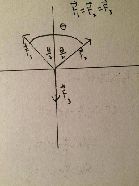

Given the free-body diagram below, and that the body is in equilibrium, find θ.
F = ma

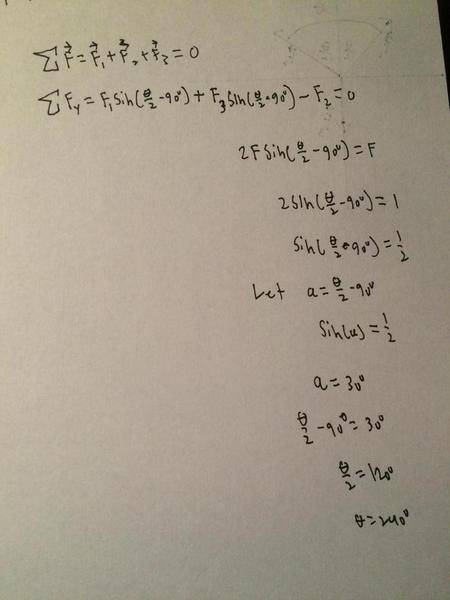

Basically, I used Newton's second law in the y direction.
Here is my work:
This does not seem like the correct answer, because the angle is acute. Thus, what am I doing wrong?

First of all, the three forces may have equal magnitude, but they are not equal as vectors.
That should be cos(θ/2) or equivalently sin(90° - θ/2)
So θ = 120 degrees?
Mr Davis 97 said:
So θ = 120 degrees?
Yes.
