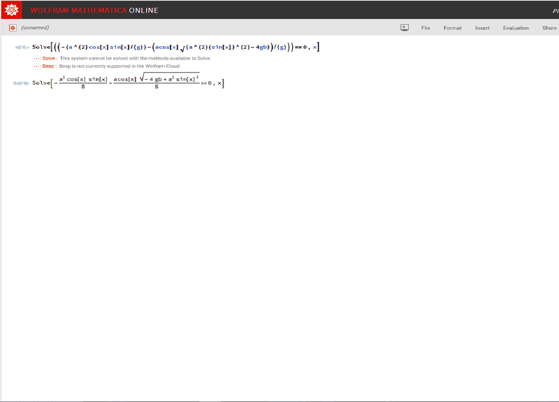

Here is what I mean,
When I try to get an equation solver to solve for x, it says that it can not do it. This was the correct formula for our derivative right? So if i set it equal to 0 and assume the rest of the numbers are constants then I should get x in terms of all of those constants but nothing can find that for me.
NOTE: if it is hard to see the image hold ctrl and scroll in, sorry I quickly pasted and cropped it out in MS Paint

I don't know if you have the correct formula for the derivative, since I cannot read your posted image. Just type it out; avoid posting images if at all possible. Sure, it takes a bit of time and is a bit of trouble, but so what? Helpers type out complicated formulas all the time, usually using LaTeX. For example, see post #7. You can also type it in plain text, using u^2 for ##u^2## , sqrt(something) for ##\sqrt{\text{something}},## a/(b+c) for ##\frac{a}{b+c}## etc.
