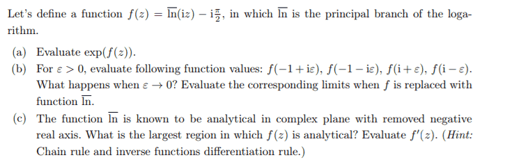

Hey everyone! I got stuck with one of my homework questions. I don't 100% understand the question, let alone how I should get started with the problem.
The picture shows the whole problem, but I think I managed doing the a and b parts, just got stuck with c. How do I find the largest region in which f(z) is analytical and how do I get started trying to differentiate it? Do the differentiation rules for the real ln translate to the complex one?
Thanks in advance <3
Start here: The function ln (principal value of ln) is known to be analytical in complex plane with removed negative real axis, let this region be denoted by ##D##.
The function ##f(z)=\bar{\ln} (iz)-i\tfrac{\pi}{2}## has a domain of analyticity obtained from ##D## by a rotation (this rotation is induced by the argument ##iz##). Think you can figure the rest of that out?
My complex is rusty, but if I recall correctly ##\tfrac{d}{dz}\bar{\ln }(h(z))=\tfrac{1}{h(z)}\cdot h^\prime (z)## by the chain rule. That should get you going!
