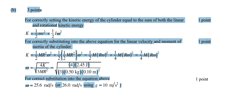

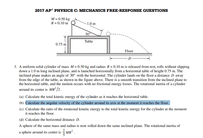

In the document below I need to try and find the angular velocity
I need help on part b
F=ma
KE_Translational= 0.5mv^2
KE-Rotational= 0.5Iw^2
Assuming g=10m/s^2
I have the answer key attached with the question but I am not sure why the answer key uses 2.5J as the sum of the kinetic energy. Why wouldn't the energy be 6.25J instead. 6.25J is the total gravitational potentia; energy relative to the ground. So shouldn't all that energy be converted into kinetic energy?

The problem says "Calculate the total kinetic energy of the cylinder when it reaches the table".

I need help on part b not a
Does the angular velocity of the cylinder change after the cylinder leaves the table?
No, since there is no net external torque

Right. Does that help to see why they used 2.5 J to get the answer for part b?
I see since the angular velocity at the table is the same as at the floor, we just calculate the angular velocity at the table. But why can't we attempt to find it at the floor directly by saying all the gravitational potential energy relative to the floor becomes kinetic energy?
All of the gravitational PE relative to the floor does become KE. But, that alone doesn't tell you what fraction of the KE at the floor will be rotational KE.

I don't think that's the crucial point. In the solution, they use KE = ##\frac{3}{4}##M(Rω)2. Under what condition is this true? Is this condition met once the cylinder leaves the table?
TSny said:
I don't think that's the crucial point. In the solution, they use KE = ##\frac{3}{4}## M(Rω)2. Under what condition is this true? Is this condition met once the cylinder leaves the table?
That can only be achieved if they assume the ball is rolling without slipping which implies v=rw. Would it be that it is no longer true because the bottom of the ball is no longer not moving with respect to the ground?
d
Yes.
I think you have it. Once the cylinder leaves the table it is no longer rolling without slipping. v increases while ω remains constant. So, as you say, v ≠ Rω after the cylinder leaves the table.
Likes Coderhk
TSny said:
d Yes. I think you have it. Once the cylinder leaves the table it is no longer rolling without slipping. v increases while ω remains constant. So, as you say, v ≠ Rω after the cylinder leaves the table.
I see, thankyou very much. I get it now.
OK. Good work.
