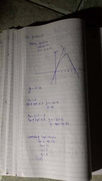

The parabola y = 6x - x^2 meets the x-axis at O and A. The tangent at O and A meet at T. Show that the curve divides the area of the triangle OAT into two parts in the ratio 2:1.
Here is my working with my sketch. So I thought I should find the area bounded the Tangent at either A or O and the x-axis to find the area of the triangle . So I integrated from x=6 to x=0 and got 108m^2.
I also wanted to check it another way so I found the coordinates of T(3,18) and used that to find the area of an isosceles triangle the normal way, but I got 54m^2. So I am a bit lost now.
And just to check something I found the area bound by the curve and the x-axis from x = 6 to x =0 and got 36m^2.
I don't know what to do with that 36m^2 yet.
I know 108:54
is 2:1... but I don't think that's the correct method.

Oh okay sorry. Area bounded the curve I'll call it C and area of Triangle AOT. C+AOT = 36 + 108 = 144
and AOT = 3C
108 = 3(36).. Hmmm so what should I do now?

Exactly what did you integrate here? Please show your work.
54 is the correct area for a triangle with base = 6 and altitude of 18. :smile:
That's the correct area under the parabola between x = 0 and x = 6.

I know 108:54
If the curve divides the area of triangle OAT into two parts with ratio 2:1, then this means that 2:1 represents the ratio of the area of the triangle which is not under the parabola to the area which is under the parabola.
You've found the area under the parabola. What is the area under the triangle OAT but also not under the parabola? What is the ratio of these two areas?

I integrated the equation of the tangent at A ; y = 36 -6x from x = 6 to x = 0. Also I integrated the equation of the tangent at O ; y = 6x for the same interval. Got 108m^2 in both cases. I was doing this because I thought the areas under either one of these curves would be the area of the triangle.
Okay, so the curve split the area of the triangle into an Area above the curve and one below it.
area of the triangle under the curve would be 36m^2.
Area above the curve would be = Area of triangle - Area below the curve = 54- 36 = 18m^2
Area of Triangle below the curve:Area of Triangle Above the Curve
36:18
2:1.
Thank you.

But why is the integral that gave me 108m^2 wrong?
Because you're integrating under a single tangent over the whole interval. (You're taking the area of a large right triangle.) You would want to integrate under one tangent for part of the interval and the other tangent for the other part.
That's the tricky thing about this triangle. The two sides of the triangle are expressed by different equations, so you can't integrate the equation for one tangent over the entire interval and expect to get the correct area under the triangle. :frown:
I just tried it over when I integrate the tangent at A from x=6 to x =3 I get 27 and when I integrate the tangent at O from x=3 to x= 0 I also get 27. So I see the 54m^2.
But I still don't fully understand why if I use the tangent at A and use the whole interval, I get 108m^2. Do you have another example of this?
