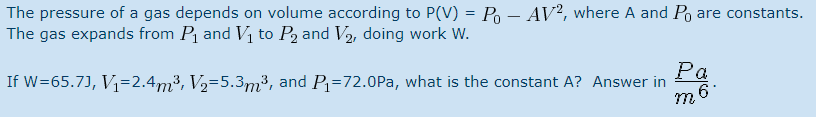

In summary: I was mistaken.In summary, the conversation is about solving for the value of A in the equation W=PVf-A(Vf^3)/3-PVi+A(Vf^3)/3=65.7=72*5.3-A(5.3)^3/3-72(2.4)+A(2.4)^3/3, where the correct answer is supposed to be 5.05. The problem arises from mixing up P0 and P1 in the equation P=P0-AV^2, leading to two equations and two unknowns. The correct equation should be P2=P0-AV2^2.

see attached
W=integral(PdV)
So I basically took the integral and ended up with W=PVf-A(Vf^3)/3-PVi+A(Vf^3)/3
so 65.7=72*5.3-A(5.3)^3/3-72(2.4)+A(2.4)^3/3
But when I solve for A I get the wrong answer of 3.179 when the answer is suppose to be 5.05. I've checked my calculation with an algebra calculator too...

You seem to have mixed up P0 and P1.

Wait wouldn't tha mean there's two unknowns then? How would I find P0?
You have two equations relating P0, P1, P2, V1, V2 and A.

Wait so is it P1=P0+AV and then the integral eqn?
No.
You are given P=P0-AV2 as a general fact. In particular this will be true at the initial and final states. Plug in the values/variables for those states to get two equations.
Likes Delta2
You have $$P_1=P_0-AV_1^2$$ so $$P_0=P_1+AV_1^2$$So you can eliminate ##P_0##

Well the problem statement says: $$P=P_0-AV^2$$so at the initial condition, $$P_1=P_0-AV_1^2$$So my algebra tells me that $$P_0=P_1+AV_1^2$$
What am I missing?
Sorry, I read what I was expecting, not what you wrote.
I read your second line as $$P_2=P_0+AV_2^2$$, reinforced by your comment about eliminating P0. So what I should have written is $$P_2=P_0-AV_2^2$$.
