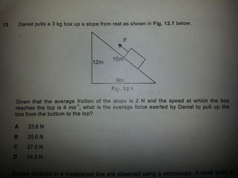

Hi all. I am marking GCSE paper that I did myself. There is 1 problem that I do not seems to understand. Please help me. Thank you very much.
Daniel pulls a 3kg box up a slope from rest as shown (Attached)
Given that the average friction of a slope is 2N and the speed at which the box reaches the top is 4m/s. What is the average form ce exerted by Daniel to pull up the box from bottom to top?
I am stuck at this part because the question does not indicate the time taken nor the acceleration. I am not able to use F=MA to find. I only have the acceleration acting on the box due to gravity is approximately 10m/s2. I am not able to use the speed to my advantage in this question.
Weight = m x g
= 3 x 10
= 30 N
I am not sure what is my next step. Hope someone can help me. Thank you!

Perhaps you could use the work-energy approach?
Hi mynameiscosine, Welcome to Physics Forums.
Actually, you can make use of the given velocity; Can you think of a kinematic equation which relates velocity, acceleration, and distance?
Hint : Remember that the initial velocity of Daniel is 0.

mynameiscosine said:
I can do this but I am not sure if I am over-complicating this.
a = acceleration
v = velocity
a = (4-0)/t
= 4/t
integrate a = v
v = 4 ln (t)
This is not correct. In the equation a = (4 - 0)/t, t denotes the total time. This is not the "current" time you can use to go from acceleration to velocity via integration.
I am not sure if my next one is right,
E = 30 N x 12
= 360J
Work done = R x 15
R = 360/15
= 24N
What can I do from here?
This attempt is better, but still not entirely correct. You assign only potential energy to E, while it must be total energy.

What happened to the energy lost due to friction?
EDIT:
Consider what work the applied force has to do. It has to:
1) Raise the box by some amount against gravity
2) Provide the box with some final velocity
3) Create some heat due to sliding friction along the ramp.
Can you identify the types of energy associated with each of the above and then write an equation to balance the work done?

Again, this equation introduces the variable t (and it's just a generalized variant of the one you tried previously). No, the equation you're looking for is: vf2 - vi2 = 2ad. Note that only velocity, acceleration, and distance variables are used in this equation.
I am sorry, how do I calculate the energy lost due to friction in this case?
Thank you!
What's the frictional force? What's the distance over which it acts?

Oh I got what you mean now! Sorry for getting it slow!
Correct me if I am wrong:
Energy loss due to friction = F x d
2N x 15 = 30J
Epotential + Ekinetic + Efrictional
= (30 x 12) + (0.5 x 3 x 42) + 30
= 360 + 24 + 30
= 414J
Am I understanding this part correctly?
After this, I must have understanding something wrongly,
Work done = R x 15
R = 414/15
R = 27.6N
Resultant force = Applied force - Frictional Force
27.6 = x - 2
x = 29.6N
Where is my mistake?
Thank you!

Yes, so far so good :smile:
Work done = R x 15
R = 414/15
R = 27.6N
27.6 = x - 2
x = 29.6N
There's no need to subtract the frictional force --- it's a component of the work done by the applied force, so it's already accounted for. Your "R" is the applied force; It's the force applied to the box in order to accomplish the work specified, which includes the work done against friction.

Oh wow. Interesting!
You made me see my mistakes in understanding dynamics!
I think sometimes I am too focus in looking at this problem in one angle. I kept trying to introduce the variable 't' into the problem instead.
Thank you so much for taking the time to explain to me. I fully understand now!
