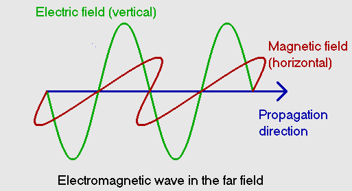

Wait, wait, wait… We’re running off in the wrong direction here. I realize there’s something out there that pro’s use to find cables and the discussion is interesting and all, but I’m curious about how this whole mess works. Yes, the RF choke does something to the circuit but I don’t understand what. Yes, it is made out of a stick of iron with wire wrapped around it. It’s an inductor, but why? Why use an inductor? What is it doing? Why wouldn’t a resistor work? Or a capacitor? Or a piece of wire? Why wouldn’t it work if a moron like me stuck his two fingers in the electrical sockets? What is that thing doing that I couldn’t do if I licked my fingers?
The other thing I don’t get is why the signal fades about 10 feet away from the break. Simon Bridge, you mention that the radiation goes out the tip. I’m sorry, but I still don’t get it… Why would this occur 10 feet away from the break? The radio is tuned to roughly 600 khz. I wonder if that particular frequency is a function of this particular RF choke and perhaps also related to the 10 feet?
So I’m envisioning an electrical wave which propagates away from the wire like a wave on the ocean in all directions like the diagram below. Except perhaps it has a preferred direction, 90 degrees to the axis of the wire, which might have something to do with the 10 feet that doesn't transmit at the end?
I am also under the impression that the wire has some electrical potential along its length which changes from + to – and back to + again at 600 khz which creates this electrical field that’s propagating outwards with the magnetic wave. Is the electrical potential along the length of the wire linearly proportional to the length of wire? Or did I drink too much beer in college?
The unit must have a circuit that does not effectively drive the loop unless there is a DC path and/or a non-infinite RF impedance. The choke provides a temporary path so the unit will work. The two antennas (now that they are not part of a loop) then have RF on them. I have no idea how they designed the driver, but it probably resonates the loop. The inductor looks like a working loop.
As for why the signal drops off as you get close to the break, it could be because you are nearing the point where two antennas driven with opposite polarity come close to each other and the fields cancel. You can test this by disconnecting one of them and see what happens as you near the break.

From your first OP, the system is effectively a radio transmitter with the wire loop as the aerial, and a receiver in the dog collar. The collar is presumably activated by the strength of the signal received, i.e the distance from the wire.
So you have to tune the radio to the transmitter frequency to pick up the signal. If the sound is just "static", it is probably transmitting an unmodulated signal (constant amplitude and frequency). Radios are usually designed to mute the audio output when there is no signal received. When the radio is tuned to the signal, that noise suppression is switched off. The static noise you hear is the random noise generated by the radio's circuits, unrelated to what is being transmitted.

FM radio frequencies would not be a good idea here. The wavelength is only a few meters, so a "random" shape of the loop could lead to problems with the signal strength example if the loop has sharp 90 degree bends at the corners, or doubles back on itself.
On the other hand at 600 kHz the wavelength is about 500 meters, so any reasonable sized loop will act as an untuned wire.
The specified RF choke (100 uH) has an impedance of about 380 ohms at 600 kHz. Presumably that is low enough for the transmitter to think the circuit is unbroken, but high enough so the broken loop in parallel with it still gets most of the power from the transmitter.
As somebody said earlier, this system works using the "near field" radiation from the wire. That is high close to the wire but typically falls off as ##1/d^3## compared with ##1/d^2## for the far field or ##1/d## for a directional antenna. The far field signal will be too low to interfere with a broadcast AM radio on the same frequency.
