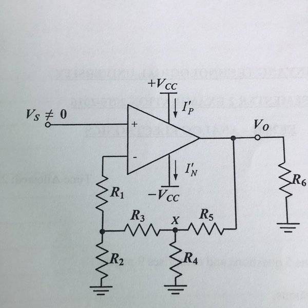

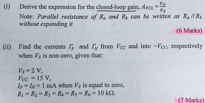

I started by trying getting voltage divider for points between R1 and R2 as (R2/(R2+R1))Vs and between R4 and R5 similarly. And I'm not sure how to continue on. Any help would be greatly appreciated.
Thanks! Full questions uploaded
Assuming the simplifying properties of an ideal op-amp, what can you say about the current through R1? What then must be the potential at the junction of R1 and R2?
