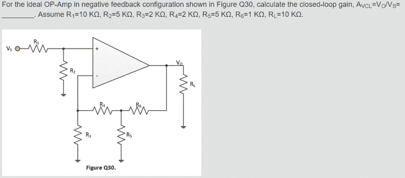

Hello there, this isn't necessarily a homework question. I came across this qn during revision and didn't know how to solve it. Any help would be greatyly appreciated.
The answer is 0.97
1. Homework Statement
For the ideal OP-Amp in negative feedback configuration shown in Figure Q30, calculate the closed-loop gain, AVCL=VO/VS= ________. Assume R1=10 KΩ, R2=5 KΩ, R3=2 KΩ, R4=2 KΩ, R5=5 KΩ, R6=1 KΩ, RL=10 KΩ.
Im unsure how to deal with the bottom bit, the resistors R3 to R6 which is connected to the inverting input. Do i try and find the Req for that bit and then treat it as Req is the feedback resistor? How would I proceed to attempt this question?
Thank you for all your help.

What you need is the feedback factor β which depends on R3...R6 only.
Forget RL because this is a load resistor only - and does not has any influence on gain (because the ideal opamp has zero output resistance - an ideal voltage source).
The feedback factor β is defined as the voltage ratio β=Vin-/Vout (Vin- is the voltage at the inverting input node).
The overall gain is according to H. Blacks formula:
G=α*Aol/(1+β*Aol)=α/[(1/Aol)+β].
For infinite open-loop gain Aol (ideal opamp) we have:
G=α/β.
(The feedforward factor is simply α=R2/(R1+R2)

H.Blacks formula and Feedforward factor arent in my course syllabus.
How do I find the feedback factor using R3 to R6? I am aware that Vo/Vs=1/β for non inverting input
Yes - but the signal is applied not directly to the non-inv. input but through a diver with the factor α.
Blacks formula can be found using wikipedia.
The feedback factor contains 4 resistors only.
It shouldn`t be a problem for you to apply the voltage divider rule twice.

You can also approach the problem using standard circuit analysis and the simplifying properties of the ideal op-amp (you should know what these are). Start by finding the potentials at the op-amp inputs in terms of Vs. Then consider what currents can flow and where in the feedback network.
Likes whatphysics
Not knowing your level of expertise
remember what i told you in the EE thread?
Since they gave you values for all resistors it is just an arithmetic exercise to figure voltages at + and - inputs.
Set them equal and rearrange that equation to give Vo/Vs.

"What's V@+input?" is easy, by inspection you know what it is.
Can you figure out Vintermediate and V@-input by plain old step by step simplifying that R3,4,5,6 string?
