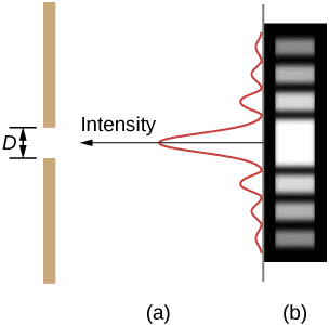

Determine the wavelength of light from the diffraction at a slit width of 0.4 mm, if the diffraction pattern is observed on the screen at a distance of 2.5 m from the slit and the second minima of the given color are 10.6 mm apart. Use the tables to determine the color of the light.

If you make a drawing and can do trigonometry you are done.
Do you understand what the "second minimum" means?

ym = m λ L / d
Wait, can i use L = d sinθ or θ =d/L
No, but you're getting there. You can use the L and the data about the position of the second minimum to find theta. Knowing it is the second minimum allows use of the equation relating d and ##\lambda## to the diffraction geometry

L=2.5m d=10.6mm and "a" (slit width) = 0.4mm
L>>d so tanθ =y/L
is y same as d ?
How to use m in the equation every value got his own angle θ for 0,1,2 ?
If "a" is right when to use it ? In what equation ?
I'm lost here
Please help me i want to know the concept.
Sorry I have lost your definitions. d is usually the slit width. "y" is the off axis distance on the detector so your equation for tan (theta) seems ok.

y= m λ L / d
meher4real said:
Then how to calculte "y" if λ isn't available ?
y= m λ L / d
You are given the information for ##y_m##:
You need to figure out what values of m correspond to the second minima.

Is "ym" same as "d" ?
Is second minima means m=2 ?

d is the width of the slit. ##y_m## is displacement from the centre of the diffraction pattern to the ##m^{th}## minimum, so the second minima are at m=2 and m=-2.
