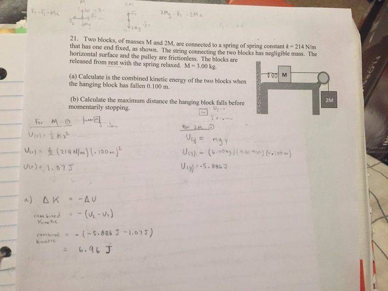

In picture
Is my setup correct for finding the combined kinetic energy in part a)
