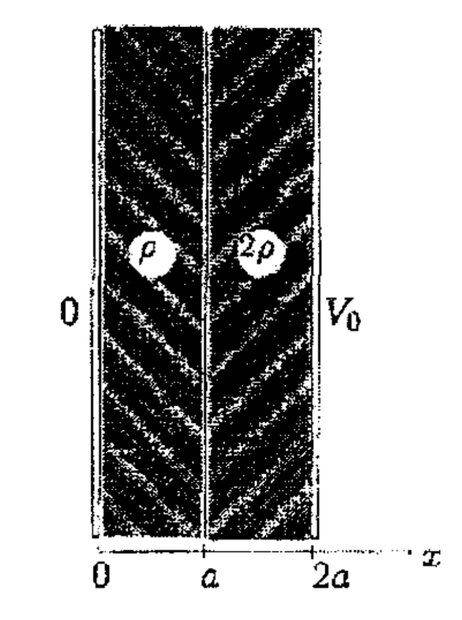

Two infinite conducting plane are a distance 2a away and parrarel. We have constant potentials on the planes. In ##0<x<a## we have charge with density ##\rho## and in ##a<x<2a## with density ##2\rho##. We want to findelectric feild and potential everywhere. And to find the charge density in boundaries.
$$\nabla .E=\frac{ \rho}{\epsilon }$$
$$ E=- \nabla V$$
$$Eup -Edown = \sigma / \epsilon$$

Potentials are relative to some arbitrary zero. A common convention is to take it as zero at infinity, but that doesn’t work when you an infinite sheet of charge that isn't tending to zero at infinity. Take the potential as zero at x=0.
The potential at any other point can then be found by integrating the field from x=0 to the point. Note that it is necessarily continuous.
There is no surface charge at x=a in the problem.
