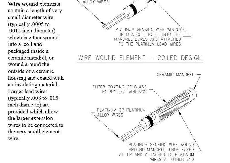

Industrial temperature detectors are wound with yet smaller platinum wire and at 1 milliamp the self heating i encountered was negligible. But we found a meter that applies 10 milliamps will heat them a degree.or so.
Here's some practical information from http://www.pyromation.com/Downloads/Doc/Training_RTD_Theory.pdf
your result seems very reasonable.
I learned something just reading your wonderful presentation of the math
