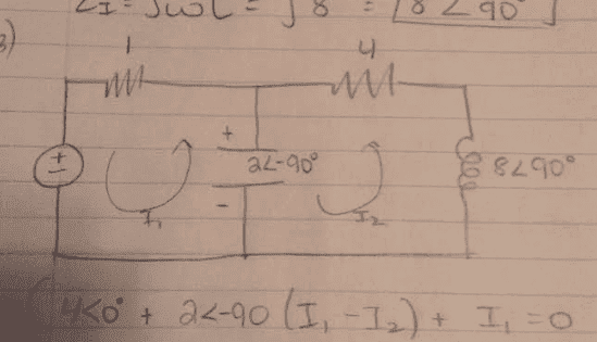

I separated it into two loops, for the left loop I got the equation
4-2I1j+2I2j+I1=0
And for the right loop:
2I1j+6I2j+42=0
Check the signs in your first loop equation. The second equation looks okay to me.

Ok, would it be
4+2I1j+2I2j+I1=0
I don't think so. How did you define the directions of the two mesh currents?
Ah. Okay, I apologize. I had initially thought that you'd defined them as clockwise currents. So your original loop 1 equation in post #10 is in fact okay. Sorry for wasting your time :oops:

No, it's fine. I guess I should define them as being clockwise in the future it will be easier.
What do I do now that I have these equations ?
I thought you'd choose clockwise in order to make ##i_2## match the direction of the defined inductor current. Otherwise the choice of direction doesn't matter much in the long run.
You'll have to solve the simultaneous equations to find the currents. In particular you'll need to find ##i_2##.

And once I solve for I2, that will be my answer right ?
Yes, once you sort out the direction difference between of ##i_2## and the inductor current. Oh, and if they want the answer in the time domain (a cosine function of t) then you'll have to convert the phasor result accordingly.

What do you mean by the direction difference?
Your ##i_2## is defined to be counterclockwise. It flows against the direction of ##i(t)## as defined on your circuit diagram.

Ok, so I should switch the equation for that loop to be:
-2I1j-62j-42
and then solve for I2, and convert if necessary and that will be the final answer ?
-2I1j-62j-42
No need to go to all that work. Just negate your result to reverse the direction of the current.
