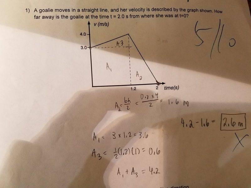

A goalie moves in a straight line and her velocity is described by the graph shown. How far away is the goalie at the time t=2.0 from where she was at t =0?
The description of the velocity/time graph:
initial velocity is 3.0 m/s and increases to 4.0 m/s in 1.2 seconds (slope m =1/(1.2)). From 1.2 seconds to 2 seconds, the velocity decreases to 0 (the slope seems to be m= -2)
Displacement = area of undercurve.
I was given the graph, so i thought displacement would be to find the area under the lines...but apparently not.
I subtracted the area that forms the square and the triangle to find the displacement and got 2.6 m/s
Can someone please tell me what I did wrong?! :(

Lori said:
here's the pic of the graph:
https://imgur.com/a/rq1Xb
[/B]
I subtracted the area that forms the square and the triangle to find the displacement, but it's the wrong answer.
My work is shown in the picture...

@Lori, why are you subtracting A2 from A1+A3?
I thought since the goalie is going in the negative direction that i should subtract them... Am i suppose to just add them all up?
Yes.
Suppose the goalie were going in the negative direction, what would that mean for his velocity?
Wouldn't his velocity be negative as well?

You would subtract areas if her velocity switched from + to - , but that is not what is happening here. Here velocity remains > 0, but decreases between t = 1.2 and t = 2 seconds. The acceleration switches from + to - , but that is a different story.

I always forget that positive velocity even if it's decreasing that it is still moving in the positive direction if it's above the x axis. Thanks for that!
