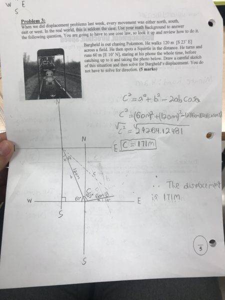

A man walks 120m [S 23 E] Then turns and walks 60m [S 10 N] draw a careful sketch of this situation and then solve for the displacement, you do not have to solve for the direction
2. Relevant equation:
Cosine law
Solution attempt is attached as a photo, I think I might have done it right but I would like someone to check it over
Jeremy Mercier said:
A man walks 120m [S 23 E] Then turns and walks 60m [S 10 N] solve for the displacement
You have transcribed the problem poorly. However, the result looks good to me.
