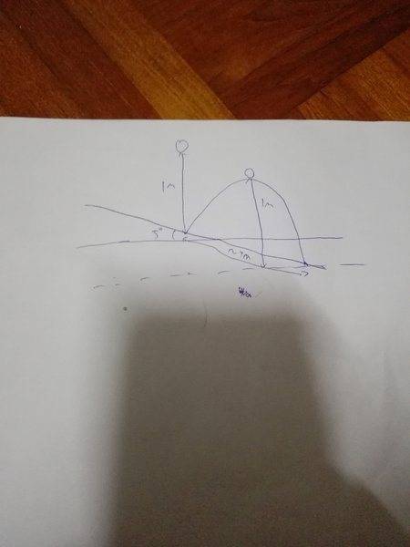

Ball falling from 1m above a slanted surface 5 degrees from horizontal. KE conserved
Find distance traveled along slanted surface on its second rebound

Sorry for not being very clear with myself.
The question basically asks for us to find distance between the first and second impact on a infinitely long slanted surface tilted at 5 degrees.
Pic attached is what I attempted to do and get the final ans of around 4(3.98)
BvU said:
Could you explain what you are doing after that ?
I do understand the question.
Let me guess (this is NOT PF culture -- instead, you should explain, as I asked :rolleyes: ) :
You use ##v = v_0 - gt = 0 \Rightarrow t = {v_0\over g} ## to find the time to reach the highest point after the bounce, 0.903 m.
However, ##\vec v_0## is not in the same direction as ##g## is acting, so you lose me at that point.
Furthermore, I also don't understand (understatement) the 85 degrees in the next line...

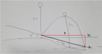

In your sketch I see 1 m above the surface as a constant -- which it may well be. Can you prove that it is a constant ?
It was just a random guess/ attempt at solving it cos the question was timed when i was doing it.:sorry: I was hoping that someone has a better explanation for the question.
After the first bounce, ##v=v_0=4.42## m/s, I agree.
Can only be if it is at 10##^\circ## wrt the vertical (##E=\vec p^2/(2m)## is conserved).
So you have ##v_x = v_0\cos(80^\circ),\ v_y = v_0\sin(80^\circ),\ ## for a parabolic trajectory.
That intersects the surface ##y = y_0 - x\sin 5^\circ## at the second bounce point.
Set up the equations and solve the quadratic equation.

sin 5°?
haruspex said:
sin 5°?

I was querying the trig function, not the angle.
With good reason o:) . Should have been ##\tan## ! Thanks!
Now we both wait for Itil to have some time to work it out ...
I got the answer its apparent 0.68something meters
Show please, how did you get that result.
Likes BvU
Sorry I was busy.
The method to solve it is to resolve the components of gravity and velocity and turn it into a projectile motion
