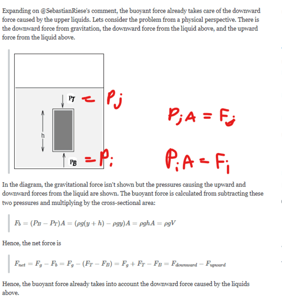

For this task, we are meant to immerse objects (held by a mesh) in water to measure the buoyant force and deduce the object densities.
We can measure the weight force of the object, ##F_g##, and tension T and buoyancy force. We need to find the downward force on the immersed object, ##F_i##
However, I am unsure how to find the downward force ##F_i## on the immersed object. Applying Newton II in the y-direction
##T + F_j - F_i -F_g = 0## where ##T## and ##F_g## and ##B = F_j - F_i## are knowns.
And solving, ##T + F_j - F_g = F_i ##, however, how do we solve this since ##F_j## and ##F_i## are unknowns.
EDIT: I think we can solve this actually since ##F_j## can be measured using a pressure sensor in the water.

I would need a diagram to understand why there are so many forces involved.

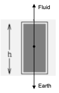

I fail to see how that relates to the task described in post #1. That only has gravitational force, the restraining force from some mesh, and a deduced buoyancy force.

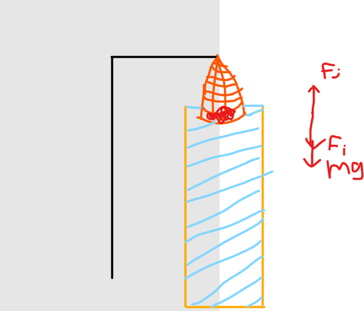

Here is the diagram @haruspex,
Where ##F_j - F_i = B##. The black line is a force sensor so we assume T = 0 then use the formula
To find the object density.
Many thanks!

No, the reading would be mg-B. Without the water there is no buoyancy, B=0, and the reading is mg.
I have no idea why the TA is naming the reading ##F_i##, or why you think it has anything to do with the diagram in post #3. Nothing in the print image refers to ##F_i## or ##F_j##. That seems to be a confusion of your own.
That image is entirely irrelevant to your experiment for reasons I already gave.

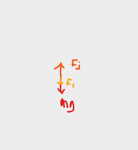

Sorry here is a free body diagram once the object is immersed in the water (whilst been inside the net):
Many thanks!
where ##F_i## and##F_j## are what?
If you are going to say they are the vertical forces exerted by the water on the top and bottom of the objects then a) what about the net? b) how do you have any hope of figuring out what their values are when the object is irregular in shape?
Forget the diagram in post #3, it is irrelevant to the thread.
Thank you for your reply @haruspex!
I am very sorry about diagram in post #3. I just realized the labels for the force are the wrong way round. My bad. I will forget about that diagram. We will use the FBD from now on which agrees with the course readings.
##F_i## = downward force exerted from water on top of immersed object
##F_j## = upward force exerted from water on bottom of immersed object
a) The net of the forces from the water acting on the object is the buoyancy force. ##B = F_j - F_i##.
b) I am not sure. We only had one irregular object.
Many thanks!

Callumnc1 said:
(B) Fluid.
If it's the force exerted by the fluid, then it must be the buoyant force. However, the buoyant force is directed up. If I look at your drawing in post #19, I see that you have drawn ##F_i## down. Here are more choices in view of your answer and that drawing:
(A) ##F_i## should have been drawn up instead of down in order to represent the buoyant force correctly.
(B) ##F_i## is not the buoyant force and has no place in the FBD.
(C) ##F_i## is correctly drawn but should be identified as the weight because the Earth is the only entity that exerts a down force on the mass.
Likes member 731016
  • #31
Thank you for your reply @kuruman!
Ok so it is definitely not (A). I don't think it (B) either since ##F_i## is not a buoyant force but one of the two forces from the water that add to form a resultant force we call the buoyant force.
So it must be (C). It seems strange, I am not use to the concept. How could ##F_i## be identified as a weight?
Many thanks!

As you contemplate answering @haruspex's question in post #32, also think about your BFD in post #19. It shows two forces directed down and one force directed up. In post #27 you claimed
Callumnc1 said:
I see how the forces are put together.
If that is indeed the case, then you should agree that the correct FBD should show two forces directed up (mesh and fluid) and one directed down (Earth.) Remember, that you should draw one arrow for each entity exerting a force. So let's see you post a correct FBD with 3 arrows, 2 up and 1 down labeled with the names of the entities that exert the forces represented by these arrows.
To help guide your thinking, I show below a FBD of the block of fluid in the figure from post #3. There are two entities exerting a force on this block, Earth (down) and Fluid (up). It says that "water floats on water" and that the two forces have equal magnitudes and opposite directions. If I label the force exerted by the Earth ##mg## and the force exerted by the fluid ##BF##, it follows that ##BF=mg.## Note that, for this particular situation, the force exerted by the fluid is the sum of an up force exerted by the fluid at the bottom of the block, ##F_B=p_BA## and a down force exerted by the fluid at the top of the block, ##F_T=-p_TA.## The single arrow representing the net force exerted by the fluid on the block is the sum of the two which is called the buoyant force, ##BF=p_BA-p_TA.##
For some reason that I do not understand, your professor and/or your TA impressed upon you that ##F_T## is important in the analysis of your experiment. In my opinion it is not and I think @haruspex agrees with me. I recommended that you abandon ##F_i## and ##F_j## because they only serve to confuse you and prevent you from seeing clearly what is going on. Their usefulness extends no further than the derivation of the Archimedes principle, namely that the buoyant force is equal to the weight of the displaced fluid. That's all you need to draw correct FBDs related to floating or immersed objects as in the case of your experiment.
Likes member 731016
