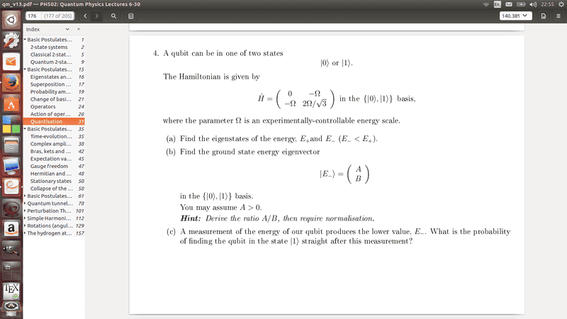

I am having a issue with how my lecture has normalised the energy state in this question.
I will post my working and I will print screen his solution to the given question below, we have the same answer but I am unsure to why he has used the ratio method.
Q4. a), b), c)

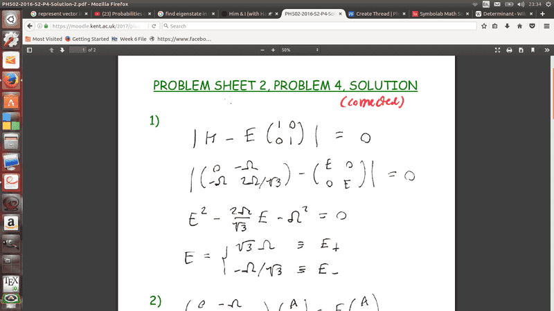

So expanding out and finding the determinate of the following matrix
$$\begin{pmatrix}-E&-\Omega \\ \:-\Omega &\frac{2\Omega }{\sqrt{3}}-E\end{pmatrix}=0 ; [6]$$
$$\begin{pmatrix}-E&-\Omega \\ \:-\Omega &\frac{2\Omega }{\sqrt{3}}-E\end{pmatrix}= E^2-\frac{2E\Omega }{\sqrt{3}}-\Omega ^2=0 ;[7]$$
$$\left(E-\frac{3\Omega }{\sqrt{3}}\right)\left(E+\frac{\Omega }{\sqrt{3}}\right)=0 [8]$$
So solving gives me the following for ##E_{-}## and ##E_{+}##
$$E_{-}=\frac{3\Omega }{\sqrt{3}} ; [9]$$
$$E_{+}=-\frac{\Omega }{\sqrt{3}} ; [10]$$

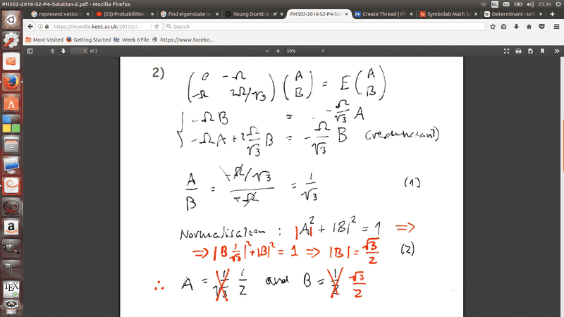

b) I solved the eignvector for ground state in the following way
$$\begin{pmatrix}0&-\Omega \\ -\Omega &\frac{2\Omega }{\sqrt{3}}\end{pmatrix}\begin{pmatrix}A\\ B\end{pmatrix}=-\frac{\Omega }{\sqrt{3}}\begin{pmatrix}A\\ B\end{pmatrix} ; [11] $$
$$-\Omega B= -\frac{\Omega }{\sqrt{3}}A ; [12]$$
$$-\Omega A=-\frac{3}{\sqrt{3}}B ; [13]$$
So solving for both of these give ##A=\sqrt 3## so therfore:
$$E_{-}= |0> + \sqrt 3 |1> ; [14]$$

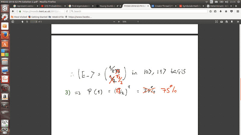

$$|E_{-}> = \frac{1}{2} |0> + \frac{\sqrt 3}{2} | 1 > ; [19]$$
c) $$P(1)=\left(\frac{\sqrt{3}}{2}\right)^2=\frac{3}{4}=75\% [20]$$

I just don't understand the ratio method, it is a quicker method than mine or is it used more in more difficult matrices
Check your work here. You cannot deduce that ##A=\sqrt 3## from equations [12] and [13]. These equations determine only the ratio of A to B.
It looks like you let ##A = 1## here; whereas, you claimed ##A = \sqrt 3##.
In the lecture's solution you find
Check this. The last equation for ##\frac{A}{B}## does not look correct.

Sorry, that was a typo. It is meant to be ##A=\sqrt 3 B## so then I throught that as the simplest number for A would be 1 then B would be ##\sqrt 3## time that, so then I got the column vector: ##\begin{pmatrix}1\\ \sqrt{3}\end{pmatrix}##. Which the gave me ##E_{-} = |0> + \sqrt 3 | 1 >## and then I normalised
If you substitute ##A=1## in the relation ##A=\sqrt 3 B##, what do you get for ##B##?
Sorry, i will correct this and hopefully will have the correct ans this time. ##E_-=\begin{pmatrix}1\\ \frac{1}{\sqrt{3}}\end{pmatrix}## so then once I have normalized I get the following, ##|E_->=\frac{\sqrt{3}}{2}|0>+\frac{1}{2}|1>## So then my ans for c) would be ##25 ##%. Hopefully this is now correct?
Yes, that looks correct.
