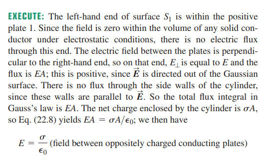

Finding electric field between two conducting plates using Gauss's law
##\epsilon_0 \oint \vec E \cdot d \vec A=q_{net,enc}##
This picture is from Sears and Zemansky's University Physics.
It considers ##S_1## as a gaussian surface then it finds electric field between two plates.

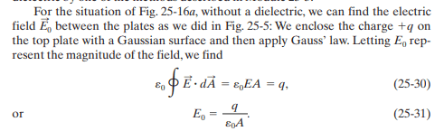

The only thing that I cannot understand is why it doesn't consider the electric field due to negative charges on other plate. Then electric field between plates should be ##\frac {2\sigma}{\epsilon_0}##.Same thing happened in Fundamentals of Physics(Textbook by David Halliday).

Who says it doesn't? It seems you don't understand Gauss's law. The symbol ##E## in Gauss's law stands for the total field at area element ##dA##, not just the field due to the enclosed charge.
At the flat pillbox surface between the plates, the total field is ##E## and at the other surface inside the plate is zero. So $$(E+0)A=\frac{q_{enc.}}{\epsilon_0}=\frac{\sigma A}{\epsilon_0}\implies E=\frac{\sigma}{\epsilon_0}.$$ Another way to see it is this. Each of the planar charge distributions contributes an electric field of magnitude $$E=\frac{\sigma}{2\epsilon_0}.$$ Between the plates, the contributions are in the same direction so the total field is the sum of the magnitudes. Inside the conductor, the contributions are in opposite directions resulting in zero.
Thanks a lot for your reply.
I've read this statement in my book but I didn't understand it correctly. So I can't use Gauss's law to find the electric field of a charge distribution inside the closed surface.(since this law relates net charge inside the surface and total electric field.)
But I can do that If there's no charge outside of the surface and we have only charge inside.

It looks like you still don't understand what Gauss's law says. Consider it in the form $$\epsilon_0\oint \vec E \cdot d\vec A=q_{enc}$$You can view it as a set of instructions to perform two tasks.
Task 1
  1. Take a closed surface ##S## that forms the boundary of volume ##V##, like the skin of a potato.
  2. Subdivide the skin of the potato into small directed area elements ##d\vec A##. This means that each element has magnitude ##dA## and points perpendicular to the surface and outward, away from the skin.
  3. At each element find ##\vec E \cdot d\vec A## which is the perpendicular-to-the-surface component of the total electric field multiplied by ##dA## at the location of that particular ##dA## and ##\epsilon_0##.
  4. Add the result in the memory of your calculator.
  5. Repeat with the next element and the next and the next until you cover all the elements on the skin.
  6. Recall the number in the memory of your calculator which is the sum of all the products. Call it the left-hand-number.
Task 2
  1. Dice the meat of the potato into small element each of volume ##dV##.
  2. Find the total charge in element ##dV##.
  3. Add the result in the memory of your calculator.
  4. Repeat with the next element and the next and the next until you cover all the elements that make up the meat of the potato.
  5. Recall the number in the memory of your calculator which is the sum of all the charges. Call it the right-hand-number.
At this point you have two numbers that you have obtained by performing two completely separate tasks. Gauss's law is the assertion that these two numbers are the same. It is an experimental result and always holds but cannot always be used to calculate electric fields.
Crudely, it says that if you walk on the surface of the potato and find that electric field lines are coming out of it at all locations, you don't need to look inside to figure out that there is a net positive charge inside. Furthermore, you find that as many field lines flow out as flow in for a net of zero flux, again you don't need to look inside to figure out that there is no net charge inside. Note that no net electric flux does not mean no field at the surface. It only means that left-hand-number has just as many positive as negative contributions.
Gauss's law can be used in highly symmetric situations to find the electric field not inside the Gaussian surface, but at the Gaussian surface, i.e. on the skin of the potato. These are situations where (a) the electric field is perpendicular to the surface at each point on the skin and (b) the electric field has the same magnitude at each point on the skin.
@kuruman Thank you for your valuable reply. I understand much better now.
