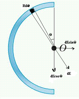

Consider an element of length dl at angle θ .Now dq=λdl and dl=rdθ .The electric field due to this tiny part dl will be dE as shown in the figure.The component of dE in horizontal direction is dEsinθ and that in vertical direction is dEcosθ.This component dEcosθ is canceled by a similar component of electric field due to element which is symmetric to this in the lower half of the semicircle.
So essentially we have,E=∫dEsinθ where dE=k(dq)/r2

btw I have another question about the direction, why is the direction of the force is pushing the point away instead of towards it, since the rod is negatively charged, doesn't that mean it should be an attraction force?

R and r are the same thing.They are the distance of the point O from each tiny bit of the rod ,equal to the radius of the semi circular rod.
Yes...the direction should be opposite to what i have shown in the figure.I didnt notice the rod was having negative charge.
