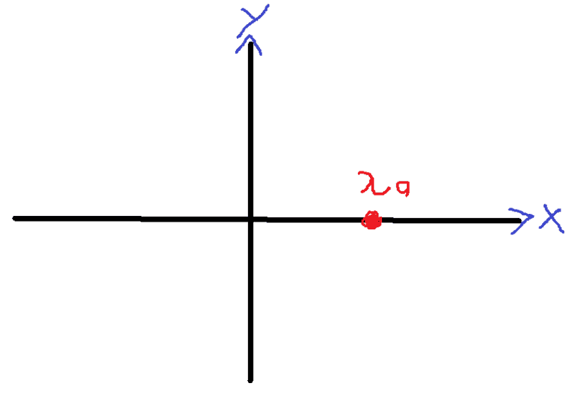

The question says:
Find the electric potential of the infinite line charge at ##\Phi \left(x,y\right)##, when known ##\Phi \left(0,0\right)=0##
I am having hard time finding the electric potential of such.
We know that the line charge is infinite at Z axis.
And we know ##\Phi \left(0,0\right)=0##
So I tried:
##\vec{r\:\:}=\left(x,\:y\right)\:##
##\vec{r'\:}=\left(a,0\right)##
##\vec{R_1}=\left(x-a,y\right)##
##\:\left|\vec{R_1}\right|=\left(\left[x-a\right]^2+y^2\right)^{\frac{1}{2}}##
##\lambda \left(r'\right)=\lambda _0##
then put at the formula:
##\Phi \left(\vec{r\:}\right)=\frac{1}{4\pi \epsilon _0}\int \:\frac{\lambda \left(\vec{r'\:}\right)dl'}{\left|r-r'\right|}##
But it wont work, the solution should be: ( according to the test )
##\Phi \left(\vec{r\:}\right)=\frac{-\lambda _0}{2\pi \epsilon _0}ln\left(\frac{r}{r_{el}}\right)##
##r_{el}=a##, forgot to mention. ( because its the relative, the ##r'##
But the problem is, it wont matter what ##dl'## I put in my formula, I wont be able to reach it.
The problem they said they want ##\Phi \left(x,y\right)\:## and not ##\Phi \left(x,y,z\right)##.
Since I can not integrate at z axis from ##\int _{-\infty }^{+\infty }\:##
FINAL ANSWER ( forgot to put it before, sorry ):
##\Phi \left(x,y\right)=-\frac{\lambda _0}{2\pi \epsilon _0}ln\left(\frac{\sqrt{\left(x-a\right)^2+y^2}}{a}\right)##
Please help, I am at this question for a long time ( it is a subquestion for the rest of the question and it crazy my mind since I can not answer that basic question ).

Is there a diagram that comes with the question? Is the line of charge along the ##x##-axis as you show or along the ##z##-axis in cylindrical coordinates?
hmm, the painting I drew is what was given.
The line of charge at ##x=a## and ##y=0## as said.
It is also infinity at ##z##, which basically means ##-\infty<z<\infty##
I don't think I have to use cylindrical coordinates, since I was given by ##X## and ##Y##.
I will reply the final answer, not just with r, I just saw I forgot to put it in here, sorry!!
And also edit at original post.
Again, Very much sorry I forgot it, maybe it made you confuse because of it!!!

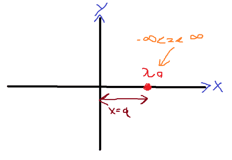

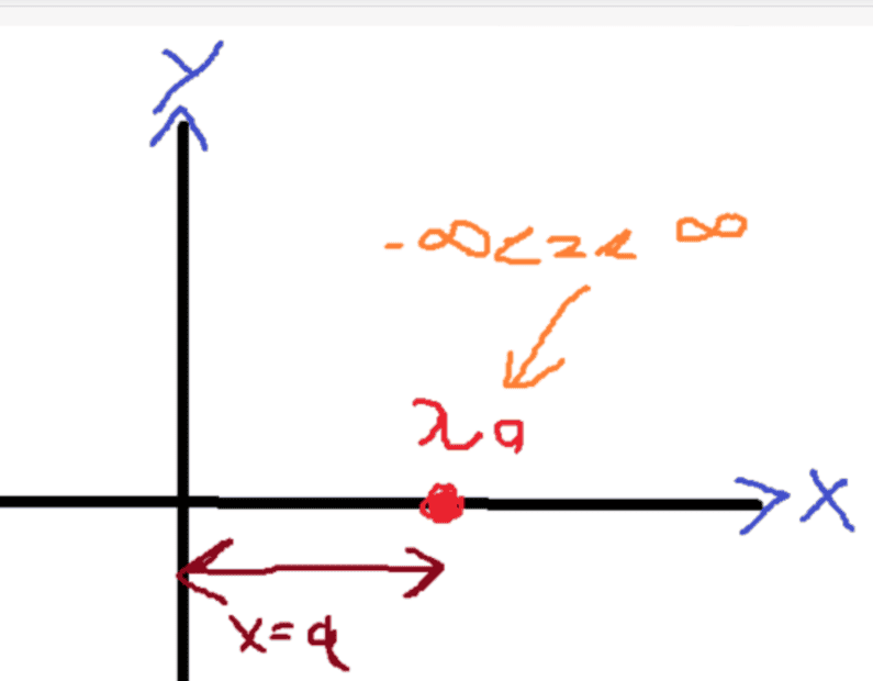

You show x and y axes and the charge distribution along the x-axis. OK. It follows that the z-axis passes through the origin and is perpendicular to the screen coming out of it. Still OK.
What confuses me is the information that are you trying to convey with the arrow labeled with ##-\infty < \lambda_a < \infty## and pointing to ##\lambda_a.##
ohh sorry, I will elaborate.
I mean by that arrow, is that the length of the line charge at z axis is infinity.
I will write again
##x=a##
##y=0##
##-\infty<z<+\infty##
That is the placement of the line charge
##\lambda=\lambda_0##

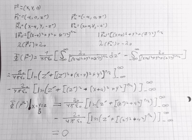

Regarding using ##(x,y,0)## and ##(a,0,z')##. I will try and update.
##\frac{\lambda _0}{4\pi \epsilon _0}\int _{-\infty }^{+\infty }\frac{dz'}{\left[\left(x-a\right)^2+y^2+\left(z'\right)^2\right]^{\frac{1}{2}}}\:=\frac{\lambda _0}{4\pi \epsilon _0}\left[ln\left(z'+\left[\left(z'\right)^2+\left(x-a\right)^2+y^2\right]^{\frac{1}{2}}\right)\right]_{_{-\infty }}^{^{+\infty }}##
Sadly, did not work also :(
I am stuck with z' as it goes to infinity. I can not seem to find a way to remove ##z'##
I guess I will give up and thats it, I see that I can not solve it. I dont want to use gauss law, to solve such questions we do not use gauss law, that I can say 100%, I am using it for "circle" stuff mostly. But again, I do not want to use Gauss.

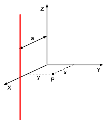

From your description, you are asked to calculate the potential at point P in the xy-plane as indicated in the figure below. The red line is the linear charge distribution.
Likes PhDeezNutz, MatinSAR, nasu and 1 other person

Ok, so now you are running into the actual issue with your approach here. The Green’s function you have used (potential for a point charge) presumes that the potential at infinity is zero. However, that is not what your problem specified. It specified that the potential at the origin should be zero.
Luckily, potentials that only differ by a constant are equivalent - they lead to the same field. So instead of adding potentials that have been chosen to be zero at infinity, you need to use potentials that are zero at the origin.
Ultimately, the reason you are getting an infinity is that if you put the zero level of the potential at a finite point, then the potential at infinity diverges. Trying to force the potential at infinity to zero is therefore a bad idea.

From your description, you are asked to calculate the potential at point P in the xy-plane as indicated in the figure below. The red line is the linear charge distribution.View attachment 336842
Based on the OP, I would say the problem asks for an arbitrary point. However, the problem is invariant under z translation so only the x and y values can possibly affect the potential. Therefore one might as well pick z=0 and infer that the sane x and y values will gove the same result for any other z.
Exactly, that is how you should graph it, was not given like that, but that is the point.

You need to add a constant (not depending on x, y, of z - possibly depending on x’, y’, and z’) to the point charge potential that you are using. Since this just adds a constant, it does not affect the fields.
I believe I covered this problem snd its solution in great detail in my book should you have access to it via your university library or similar.
physics1000 said:
Third paragraph, Then what should I do?
You should do what I just told you. Use a shifted point particle potential.

The original exercise ( as you will see in the picture has two infinite line of charge, but don't mind it, one at ##x=a## the other at ##x=-a##, the problem is in the integral ).
Ahh, I seriously do not understand what do you mean by that, nothing...
I tried ( what I managed to understand from your thing )
Tried to do ##X=Y=Z=0## and not ##X'=Y'=Z'=0## of course.
In The case of the post ( not the two infinite line charge, cus it does not matter ), I will just receive
##V_0 =# #minus of all the first integral. Or again, I do not understand again...
  • #41
You have an integral of the form ##\int_{-\infty}^{\infty}\frac{dz}{(A^2+z^2)^\frac 12}##. I don't understand the next line. Please post your working of the integration.
