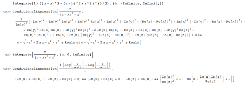

I also tried using Mathematica to solve this expression and evaluate the limits (by setting x' as a, y' as b), and it gave me the following:
Which is quite a complicated conditional expression.
It will help if you let Mathematica know that all of your parameters are real. So, you can try adding an "Assumptions" option in your Integrate command:
Here, I specified ##x## and ##y## as real. Also that ##z>0##, which implies that ##z## is real and that we are avoiding ##z = 0## which would put us right on the plane. I don't know Mathematica that well, so there could be a nicer way to do this.
Thanks, I didn't know you could add assumptions to the integration, but it indeed after adding them it simplified a lot the solution:
$$Int(r)=\frac{1}{z}(\pi+2Arctan(\frac{x}{z}))$$
And substituting into the potential:
$$\Phi(r)=\frac{V_0 z}{2\pi}Int(r)=\frac{V_0}{2}(1+\frac{1}{\pi}Arctan(\frac{x}{z}))$$
Which now makes sense, as when ##x\rightarrow \infty## the second term vanishes and we recover the potential of an infinite plane, yet when it is close to zero we indeed get a complex behavior near the boundary of the two planes. Therefore, I think the problem is solved.
