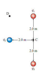

An object with charge +2.0×10−5 C is moved from position C to position D in the figure (Figure 1) . q1 = q3 = +10.0×10−5 C and q2 = −20.0×10−5 C. All four charged objects are the system.
Here's a picture to the problem
$$ F = \frac {kq_1 q_2}{r^2} $$
$$ U_e = \frac {kq_1 q_2}{r} $$
$$ a^2+b^2=c^2 $$
I first attempted finding all the energy for the system by finding the initial potential electric energy for each pair of charged objects and added them together. I managed to find the distance from ## q_2 ## to ## q_1## and ##q_3## using Pythagorean theorem.$$ c → q_1, c → q_2, c → q_3, q_2 → q_1, q_2 → q_3 $$
Unfortunately after putting the added energies it came up as wrong.

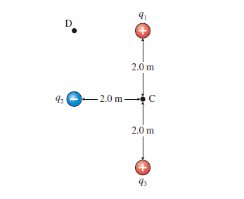

This is the picture :

Have you left out the pair q1-q3?
Ah yes! It appears I did. However, even without having it I was getting 126 J. It says that the answer is -105 J. So that tells me I messed up somewhere while calculating with all the ##U_e##'s.

These are the numbers I got along with the added ##q_1, q_3##
$$ U_{c,q1} = \frac {(9*10^9)(+2.0*10^{-5}) (+10.0*10^{-5})} {2.0} = 9\ J$$
$$ U_{c,q2} = \frac {(9*10^9)(+2.0*10^{-5}) (-20.0*10^{-5})} {2.0} = 18\ J$$
$$ U_{c,q3} = \frac {(9*10^9)(+2.0*10^{-5}) (+10.0*10^{-5})} {2.0} = 9\ J$$
$$ U_{q2,q1} = \frac {(9*10^9)(-20.0*10^{-5}) (+10.0*10^{-5})} {2\sqrt2} = 45\ J$$
$$ U_{q2,q3} = \frac {(9*10^9)(-20.0*10^{-5}) (+10.0*10^{-5})} {2\sqrt2} = 45\ J$$
$$ U_{q1,q3} = \frac {(9*10^9)(+10.0*10^{-5}) (+10.0*10^{-5})} {4.0} = 22.5\ J$$
You ignored all the negative signs.
I've tried it with the negative signs, but I end up getting -68. The correct answer shown was -105, so I don't know exactly where I went wrong.
You must include the signs of the charges,
And even the numerical values of U(q2,q1) and U(q2,q3) are wrong.
