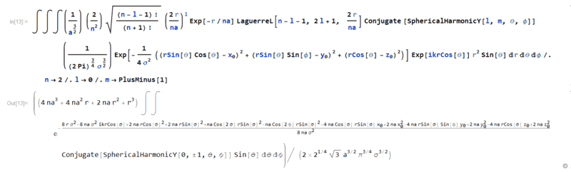

If you have Wolfram Mathematica available, you can try to calculate the integral of the wavepacket multiplied by a hydrogenic wavefunction ##\psi_{n,l,m_l}(r,\phi ,\theta )## over all 3d space, representing all position variables in spherical polar coordinates. It's likely that it's not possible, and the integrations have to be done by some numerical method.
Just used Mathematica for the first time and had to figure out how to do integration. So doing the whole integral of the scalar product gave me this, not sure if it's right or what to make of it. Any opinions would be appreciated!
