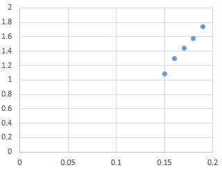

Used centripetal apparatus to run trials with varying radii but constant mass and calibration weight (mg). I have already plotted T^2 vs r^2 and got a slope of 16.5 from the best fit. I now have to solve the equation for T^2 and then use it to determine the centripetal force. I know the slope is T^2/r, but I don't know how to use that.
Mass M = .138kg
Calibration weight= .050 kg so measured force is .490.
slope = 16.5
F=4pi^2rM/T^2
T^2=(4pi^2rM)/F I've tried rearranging it many ways but I can't figure out how to use this to determine centripetal force from the slope.

From your ##T^2 = {4\pi^2rM\over F}## I would expect a plot of ##T^2## versus ##r## to give a straight line with a slope ##4\pi^2 M\over F## (very important: check this has the right dimension of ##s^2/m##)
So I wonder what your plot with a slope of 16.5 s2/m2 looks like ...

The apparatus was spun by hand (not particularly precise unfortunately) and we did not measure T. The r varied from .15 to .19 during the five trials. This is all the elements we were measuring or attempting to derive.
My plot for that was a nearly perfect 45 degree angle on positive y and x. Points used to derive slope:
y2=1.74 y1=1.08
x2=.19 x1=.15

We did measure T for each trial but they were just used to get a T2 for each point pairing on the plot.
Yeah, we used five sets of points, but I used those two for the slope. It was a nearly perfectly linear positive y and x, I'm pretty confident in the slope. My paper graph looks terrible in a photo but here's the plot in excel:

Good. Along the axis I see (dimensionless) numbers. One way to make them valid is to add a legend: ##T^2/s^2## for the vertical axis and ##r/m## for the horizontal. This is a bit puritan: ##\ T^2\ \ (s^2)## and ##\ r\ \ (m) ## is often used also.
The plot looks good and shows a linear relationship. So not the

in post # 1 but T2 vs r -- as suggested by the equation. And the slope is 16.5 s2/m. Or is it ?
From your two points I get ##{\Delta T^2\over \Delta r} = {0.66\over 0.04} = 15.5\ ## s2/m
There is one big problem remaining, though: how do you explain that the plot of the relationship clearly does not go through the origin as the formula says :wideeyed: ?

That was a typo, and yeah, I just whipped up that graph as an example, normally I'd add units. That slope is probably more accurate. I don't really know why it doesn't go through the origin :/ That's just the data we got from the experiment...
At this point I'm sort of desperate to derive some value for F from the equation though. I don't understand how to use it or even get started past rearranging for T2=. I've tried subbing in values, moving terms around, rewriting F as mg... just don't get it.

From this slope you get ##{4\pi^2 M\over F} = 16.5 ## s2/m so, unless you have M, all you can find is M/F ...
