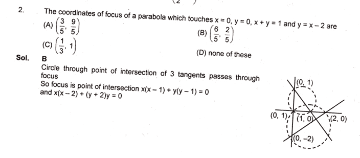

Now that I have reached the answer, I compared our solution with the given solution. Please look at the attachment.
I have no idea what the solution is doing, can you please help me understand the solution? :confused:

I agree with your solution $(6/5,2/5)$. That geometric solution is extremely slick. It relies on a theorem (unknown to me) saying that the circumcircle of the triangle formed by any three tangents to a parabola passes through the focus. If you accept that theorem then the next step is to find the equation of the dashed circles in the diagram. [There is a misprint in the diagram: the origin should be labelled as $(0,0)$, not $(0,1)$.] The smaller circle passes through $(0,0)$, $(1,0)$ and $(0,1)$. You can quickly find its equation using the fact that the equation of a circle is always of the form $x^2 + y^2 + ax + by + c = 0$. If it goes through the origin then $c=0$. Then if it goes through $(1,0)$ you must have $a=-1$ and if it goes through $(0,1)$ you must have $b=-1$. So its equation is $x(x-1) + y(y-1) = 0$. Similarly for the larger circle.
The two circles intersect at the points where $x(x-1) + y(y-1) = 0$ and $x(x-2) + y(y+2) = 0$. Solving those equations (start by subtracting one from the other), you find that the intersection points are $(0,0)$ and $(6/5,2/5)$.

Btw, I found something which could be of interest. Here it is: The Parabola . Scroll down to Lambert's theorem.
