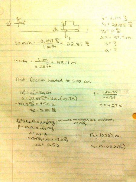

I first converted everything to meters and seconds.
So, initial velocity is 22.35 m/s and distance traveled is 47.7 meters.
Then, I found acceleration, which is -5.24 m/ss.
Then, I found time. 4.27 seconds
I tired to find the coefficient of friction with:
F=ma=u(mg) (n is the same as mg because the surface is level)
ma=u(mg)
a=ug
-5.24=u(-9.8)
u=0.53
I have no idea what to do now. It wants the friction force, not the coefficient.
those are pretty much the only formulas we have at this point. We haven't gotten to work or energy formulas.

Maybe all they want is the force in g's.

Yeah, that's kind of what I'm guessing now. There certainly is no mention of the car's mass in the problem statement, so I guess it just needs to show up in the answer as Amy did...
BTW, Amy -- your files were JPG files, so you should be able to click the UPLOAD button in the Reply window to upload a *lJPG file as an attachment.
Also, we usually do not want your work to be an image, and prefer that you type it into the PF directly. Just a note for future posts... :smile:
Your answer could be expressed as "some specific fraction of the magnitude of the car's weight."
