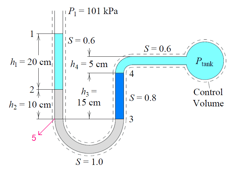

Hi everyone. I would like to ask how do you find the gauge pressure at point 4.
I know the formula, which is:
Pgage = Pabs - Patm
But I don't know which one is the Pabs.
This is my attempt:
P4 = (600 kg/m^3 × 9.8 m/s^2 × 0.05 m) + Ptank
This is all I can do.
Please professors help me on this.
Tell me please the clue and hints as much as possible.

You ask that as though Pabs is the pressure at some particular point; it isn't. At every point you can express the pressure either relative to atmospheric pressure (that is its "gauge" pressure) or as its absolute pressure Pabs, i.e. relative to absolute zero pressure. The difference, of course, is atmospheric pressure, Patm.
Since you don't know Ptank, that is not going to help. Start at a point where the pressure is known.

The whole mass of liquid inside the gauge is under the atmospheric pressure (P1) shown at the open end.
The weight of the columns of liquid (hydrostatic pressure) only adds up to that value for each section located under the liquid surface.
The lower each section of tube is below the open surface, the greater the total pressure is within the liquid.
Therefore, it would have a maximum value at the bottom of the U-shape.
Section 4 is in between that point and the open surface.

In order to find the ##P_{gage}## at point 4, do I have to find the value of the ##P_{tank}## first?
If yes, this is what I got:
##P_{tank} + \left( 600 \ \frac{kg}{m^3} × 9.8 \ \frac{m}{s^2} × 0.05 \ m \right) + \left( 800 \ \frac{kg}{m^3} × 9.8 \ \frac{m}{s^2} × 0.15 \ m \right) = \left( 1000 \ \frac{kg}{m^3} × 9.8 \ \frac{m}{s^2} × 0.1 \ m \right) + \left( 600 \ \frac{kg}{m^3} × 9.8 \ \frac{m}{s^2} × 0.2 \ m \right) + P_{1}##
##P_{tank} + 294 \ Pa + 1,176 \ Pa = 980 \ Pa + 1,176 \ Pa + 101 \ kPa##
##P_{tank} + 1,470 \ Pa = 2,156 \ Pa + 101 \ kPa##
##P_{tank} = 2,156 \ Pa - 1,470 \ Pa + 101 \ kPa##
##P_{tank} = 686 \ Pa + 101 \ kPa##
##P_{tank} = 0.686 \ kPa + 101 \ kPa##
##P_{tank} = 101.686 \ kPa##
What is the next step?
Is it available another way to find the value of the ##P_{gage}## at point 4 without have to find the value of the ##P_{tank}## first? If yes, how to do it step-by-step?
If you would imaginarily remove the pipe and tank and liquid above cross-section 4, how much pressure you would need to apply on that surface to keep the liquid columns as balanced as the diagram shows?
No. (Also, it's worth noting that the the tank-pressure is not a single value. The pressure at the top of the tank is less than the pressure at the bottom, though this is not an issue here.)
This doesn't help. But note, it gives the pressure at point 3, not point 4.

The rules here mean that we won't give you a step-by-step answer. But see if this helps.
What are the the pressure-differences between:
a) point 1 and point 2?
b) point 2 and point 3?
c) point 3 and point 4?
Does knowing these values help you answer the question?

The pressure difference between point 1 and point 2 is:
##P_{2} - P_{1} = \left( 600 \ \frac{kg}{m^3} × 9.8 \ \frac{m}{s^2} × 0.2 \ m \right) = 1,176 \ Pa##
The pressure difference between point 2 and point 3 is:
I don't know, please tell me how to find this pressure.
The pressure difference between point 3 and point 4 is:
Please help me slowly.
Why can't you use the same metod for the other pressure differences? You did it for the difference between 1 and 2.

The pressure difference (##\Delta P##) between any 2 points (height difference ##\Delta h##) in a continuous 'section' of a single liquid (density ##\rho##) is given by: ##\Delta P = \rho g \Delta h##.
This pressure difference is not affected by what's outside, or by the shape of, the 'section’ of liquid.
Look at the Post #1 diagram. Between points 2 and 3 there is a continuous section of a single liquid with density 1000kg/m³. Point 3 is 10cm lower than point 2.
Can you now work out the pressure difference between points 2 and 3.?
Can you now work out the pressure difference between points 3 and 4?
And then, can you use the three pressure differences you have found to answer the question?
##P_{3} = P_{5} = \left( 1000 \ \frac{kg}{m^3} × 9.8 \ \frac{m}{s^2} × 0.1 \ m \right) + P_{2}##
So, the pressure difference between point 2 and point 3 is:
##P_{3} - P_{2} = \left( 1000 \ \frac{kg}{m^3} × 9.8 \ \frac{m}{s^2} × 0.1 \ m \right) = 980 \ Pa##

OK, now how do I find the pressure difference between point 3 and point 4?
Is it including a ##P_{tank}##?
I don't understand after read the post #15.
Is it including/consist of ##P_{tank}##?
Please anwer this question.
If the answer is yes, then I will write it.
Steve4Physics said:
Yes, good.The pressure difference (##\Delta P##) between any 2 points (height difference ##\Delta h##) in a continuous 'section' of a single liquid (density ##\rho##) is given by: ##\Delta P = \rho g \Delta h##.
What is confusing in the above? It is quoted from post 15.
Likes Steve4Physics
##P_{3} = \left( 800 \ \frac{kg}{m^3} + 9.8 \ \frac{m}{s^2} + 0.15 \ m \right) + P_{4}##
So, the pressure difference between point 3 and point 4 is:
##P_{3} - P_{4} = \left( 800 \ \frac{kg}{m^3} + 9.8 \ \frac{m}{s^2} + 0.15 \ m \right) = 1,176 \ Pa##
Is this correct?
It looks OK to me.
OK, now what is the conclusion of all of these pressure differences? What it has to do with the ##P_{gauge}## at point 4?
Can't you find the pressure at point 4 after you have calculated all these differences?

A diver is going to explore a winding flooded tunnel.
At the start point, A, before jumping in, his pressure gauge reads 10 units (atmospheric pressure).
He jumps in and eventually reaches point B. From A to B, the pressure increased by 5 units.
He reaches point C. From B to C, the pressure increased by 10 units.
He reaches point D. From C to D, the pressure decreased by 3 units.
Questions;
a) What is the absolute pressure at D?
b) What is the gauge pressure at D?
Are you saying that by combining all of these 3 pressure differences, I may find the value of ##P_{4}##?
Yes - assuming you combine them correctly of course. Please answer the questions in Post #26 so we can check your understanding.

a) Is it 22 units?
b) Is it 22 units - ##P_{atm}##?
atpeef said:
a) Is it 22 units?
Yes, that's the absolute pressure.
Yes, that's the gauge pressure. Note that you are told ##P_{atm}## = 10 units so the gauge pressure is 22-10=12 units.
Can you complete your original question now?
