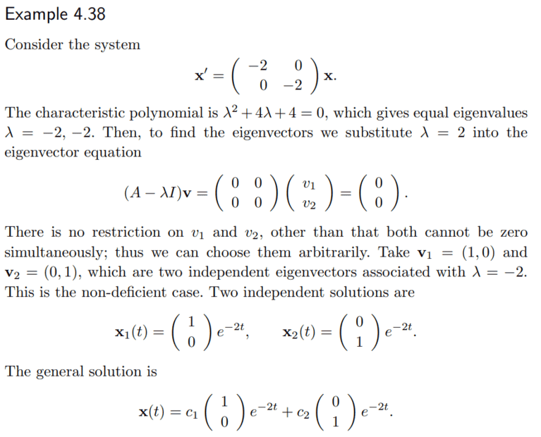

Please see below. I am unsure why the example says we cannot choose ##v_1 = (0, 0)##.
Please see below.
For this problem,
My working is,
##0v_1 + 0v_2 = 0##, however, does someone please know why the example says we cannot choose ##v_1 = (0, 0)## since from ##0v_1 + 0v_2 = 0## ##v_1, v_2 \in \mathbb{R}## i.e there is no restriction on what the vector components could be)?
Thanks!
Eigenvectors are non-zero vectors by definition.
Zero vector satisfies ##Ax=\lambda x## for any ##A## and any ##\lambda##.
  • Love
Likes Mark44, member 731016 and FactChecker
