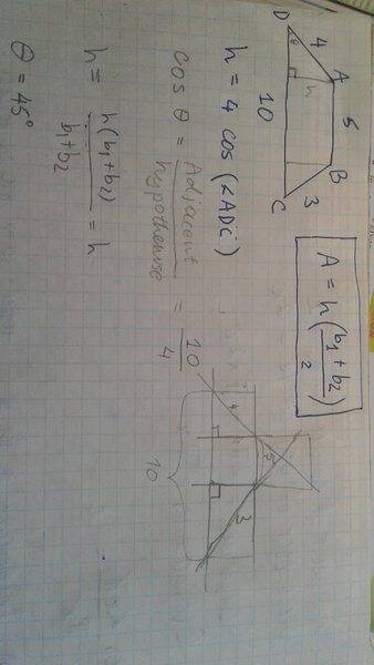

I am wondering how I can find the area of a trapezoid from its two legs and bases.
My problem:
ABCD is a trapezium with AB parallel to CD such that AB = 5, BC = 3, CD = 10 and AD = 4. What is the area of ABCD?
If we trace a straight line from A down parallel to the height of the trapezium, we get a right - angle triangle. From this triangle we can find the height by calculating the cosine of ∠ADC, then find the area by the Area of Trapezium formula. This should solve the problem, right?

I am a high school student. Unfortunately, still did not learn anything about cos, sin and tan, but I would like to know if I am on the right path with this problem.
Thank you.
EDIT: and also, do I have to solve this using cos and trigonometry, or can I use another method if it is more simple?
You only know two sides of the triangle ADC. How would you find the height?
It is possible to solve this problem without trigonometry, but there is a trick you have to find.
Likes ISamson
The hypothenuse - I know.
I also know all of the DC segment, however I am not sure what the DC-base side of the triangle is exactly. Do I?

Yes, I thought about it for a long time, and drew a sketch.
I don't know what b1 and b2 are, but the angle is not 45 degrees.
The formula you use for the angle only works if you use a rectangular triangle, and the cosine of something cannot be 10/4 which is larger than 1.

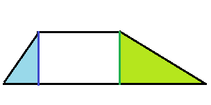

You certainly learned some famous law concerning right triangles. And you can draw two of them, with equal heights.

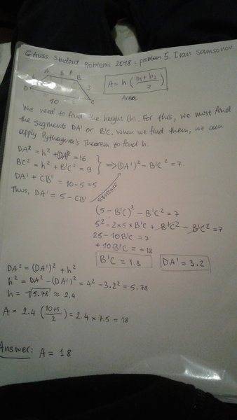

Have you done the question?
Yes. Why?
Can you see that?
ISamson said:
Yes. Why?
Can you see that?
I can see. I just didnt know whether you did an you were stuck. Good Job

Here is how I would have solved it: Draw a parallel to BC going through A. It crosses CD at point E. We know ED=AB=5, therefore DE=DC-EC=5. That's basically the idea "make the trapezoid 5 shorter" I was hinting at.
The triangle DAB has side lengths DA=4, AE=3, ED=5. It is a right triangle with the right angle at A. This is "by accident", but I think it has been done deliberately. We can express its area in two different ways: 1/2 (DA)(AE) = 1/2 (ED) h. Therefore, h=(DA)(AE)/(ED) = 4*3/5 = 12/5.
This leads to the total area A=12/5 (10+5)/2 = 18.
