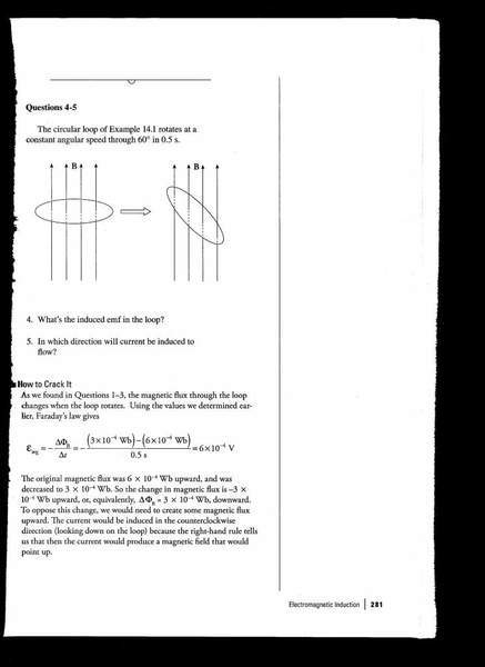

In summary, the homework equations state that induced emf will flow in the direction that opposes the magnetic flux that created it. For the first problem, the thumb represents the direction of the magnetic field and the fingers curl counter clockwise, which represents the direction of the induced current. For the second problem, the bars represent a problem that asks for the direction of the induced current and the thumb again represents the direction of the magnetic field. However, the right hand thumb rule still works if we make the thumb represent the direction of the current and the fingers represent the direction of the field.
joej24
78
Attached below
Emf = - [itex]\Delta[/itex][itex]\Phi[/itex] / [itex]\Delta[/itex]t
emf = vBl; motional emf
In the two attached files, there are problems that ask for the direction of the induced current.
I understand that the induced current flows in the direction that opposes the magnetic flux that created it.
In the first file, [itex]\Delta[/itex][itex]\Phi[/itex] is negative because flux (BAcos[itex]\theta[/itex]) was smaller in the 2nd case than in the 1st. cos 0 > cos 60.
The opposite direction of the induced current is up because [itex]\Delta[/itex][itex]\Phi[/itex] is negative
But, how would I find out the direction of the current?

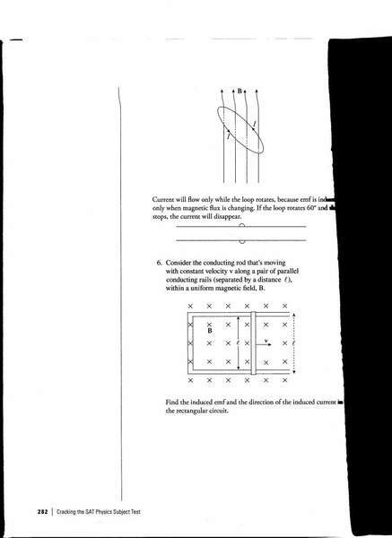

I have the same problem with the problem shown in the second file.
emf = vB l (memorized equation)
We then need magnetic flux out of the page and the magnetic field to do so as well.
Also, is motional emf the same as induced emf?

Do you know the right hand thumb rule? It only requires the current direction to tell you the direction of the induced magnetic field.
I guess I don't. I tried using F = I L B sin theta, but it didn't work out well.
There is another right hand rule mentioned in my book:
"The magnetic field 'lines' are actually circles whose centers are on the wire. The direction of these circles is determined by a variation of the right-hand rule. Imagine grabbing the wire in your right hand with your thumb pointing in the direction of the current. Then the direction in which your fingers curl around the wire gives the direction of the magnetic field lines."
Is this it? The magnetic field in both cases are lines, not circles.
This works for the second problem because by curling my fingers towards "out of the page", where the magnetic field should point according to Len'z law, my thumb points counterclockwise.
In the first problem when I curl my fingers upwards, my thumb points clockwise when the answer sheet says that current should flow counterclockwise.
right hand thumb rule works in all cases but you just have to transform it a little
in this case : if the thumb gives the direction of mag. field then the curling fingers will give the direction of circular (or closed loop) current.
so here net flux through loop is _____ then, acc. to lenz's law, the current will be ____.
Yes, the rule your book mentions is the right hand thumb rule. The magnetic field direction you are to consider is the direction of the enclosed field (as induction is due to change in flux - which is enclosed by your loops) So in the first question your know the magnetic field is going up from the loop - if you apply the thumb rule correctly, you should agree with the answer sheet.
for motional EMF you can use the eqn of force on charge in mag. field: [tex]\vec{F} \ = \ q\\vec{v}X\vec{B}[/tex]
check where wil a positively charged particle in wire will move ... that will be direction of wire ... and thus you can also find polarity of the wire.

Okay. For first problem, thumb represents the direction of the magnetic field (pointing up). The fingers curl counter clockwise.
For the second problem with the bars, thumb again represents the magnetic field (pointing up). And again, the fingers curl counterclockwise, which represents the direction of the induced current.
Would the right hand rule still work if we made the thumb represent the direction of the current and the fingers represent the direction of the field?
Also, what's the difference between motional emf and induced emf? When do we use each of the formulas?
