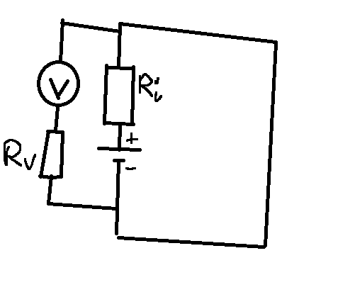

A real battery can be modeled as an ideal voltage source in series with a resistor. A voltmeter with input resistance of ##1000\Omega## measures the voltage of a 1.5V worn out battery as 0.9V. What is the internal resistance of the battery.
##V=IR##
After I had already drawn the circuit I realized it's wrong to have a wire with nothing on it along the right side but it's painful to draw the circuits so I'll just mention to ignore that section rather than redraw it.
I'm quite lost as to how to solve this question, the battery has a voltage of 1.5V so ##V_0=1.5V## but the voltmeter is reading 0.9V. Now without the right hand portion of the circuit ##R_v## and ##R_i## are in series so the current is given by ##i=\frac{v_0}{R_v+R_i}##, now from KVL ##v_0=i(R_v+R_i)## but my ##i## will just cancel out everything and I'll end up with essentially nothing. Not really sure what to do with the voltmeter reading 0.9V.
Having found the expression for the current, as you have, figure out all the voltage drops.

Ok then the voltage drop across ##R_i## is ##V_{Ri}=\frac{v_0}{R_v+R_i}R_i## and across ##R_v## is ##V_{Rv}=\frac{v_0}{R_v+R_i}R_v##, I'm not really sure what to do with these though, KVL gives ##v_0=V_{Rv}+V_{Ri}## but this doesn't seem to be leading to the solution.
What voltage drop does the voltmeter measure?

Ok I think I understand now, I believe the voltmeter measures the drop across ##v_0## and ##R_i## so ##0.9V=V_0-iR_i##?
Refer back to the voltage drops you listed in post #3. The equations you had for those were more useful. But which one does the voltmeter measure?
It may be that your diagram is confusing you. What is the purpose of the fat resistor in the voltmeter?

Not only that wire on the right is wrong: The real voltmeter can be considered as an ideal one (with infinite internal resistance) connected parallel with its resistance. And the voltmeter measures the voltage across its internal resistance.

@haruspex @ehild Ok I think I finally got the answer, since ##R_v## is in parallel with the ##R_i## branch voltage across ##R_i## is the same as the voltage measured by the voltmeter. Now the current in the circuit will be given by ##i=\frac{v_0}{R_{eq}}=\frac{v_0(R_i+R_v)}{R_iR_v}## and voltage across ##R_v## will be 0.9V since this is what's measured by the voltmeter and we obtain $$0.9V=iR_v=\frac{V_0(R_i+R_v)}{R_i} \\

NO, it is wrong. Ri and Rv are in series, and the voltmeter measures the voltage across Rv. The ideal voltmeter is not part of the circuit, it just shows the voltage between its terminals.

Ah yes I guess I forgot the voltmeter is just along a wire. Now current is given by ##i=\frac{v_0}{R_i+R_v}## and then voltage across ##R_v## will be ##V_{Rv}=iR_v=\frac{v_0R_v}{R_i+R_v}## which will be equal to the voltmeter reading of 0.9V, after solving gives ##R_i=\frac{R_v(v_0-0.9V)}{0.9V}=666.67\Omega##, I can't comprehend why it measures voltage across ##R_v## though since then our expression for ##R_i## makes no sense if we let ##R_v\to\infty##

Let me take you back to what you had in post #3
Relate the measured voltage to that.

As Rv increases, i decreases, increasing the measured voltage. In the limit the measured voltage is v0.

The voltage across Rv is the same as the voltage across the terminals of the battery. If the voltmeter resistance tends to infinity, the current tends to zero, the voltage read by the voltmeter is ##\lim_{R_v \rightarrow∞} \frac {V_0 R_v}{R_v+R_i}=V_0##
Or you can think the way that infinite Rv means zero current, then there is no voltage drop across Ri and the voltmeter reads the emf of the battery , 1.5 V.

The internal resistance of the battery does not depend on the resistance of the voltmeter, but the voltage measured depends on it. You would get a higher terminal voltage with a better voltmeter and you would read the emf with an ideal voltmeter.

It seems to me from KVL that the voltage across the terminals of the battery is equal to the voltage across both resistors, ##v_0=i(R_i+R_v)##?
No, Ri is inside the battery (the yellow box) The red dots are the terminals, and they are connected to the voltmeter.
