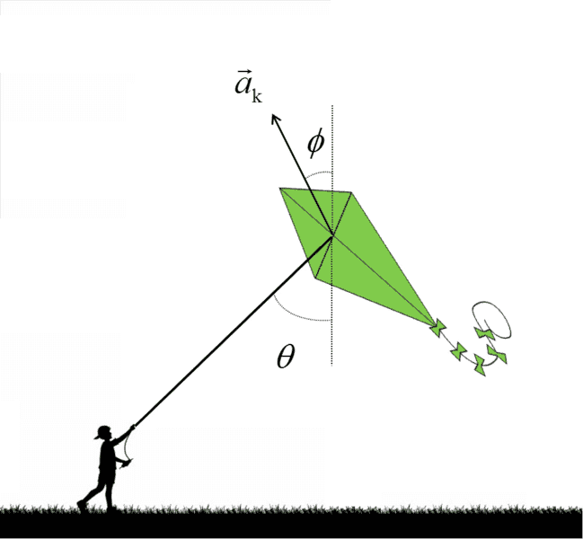

A child is flying a large kite of mass 6.8 kg on a windy day. At the moment shown the tension from the string on the kite has a magnitude of 17.0 N and makes an angle of
= 32.6° from the vertical, and the acceleration of the kite has a magnitude of ak = 7.72 m/s2 and makes an angle of
=37
6° from the vertical as shown in the figure below. The only forces felt by the kite are its own weight, the tension from the string, and a force from the wind.
(picture of problem, shows angles)

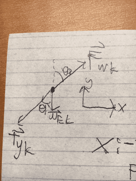

Knowns[/B]: m(kite)=6.8kg, θ(1)=32.6°(vertical angle between y-axis and string), Tension=T(yk)=17N, Φ=37.6°(angle between direction of acceleration and y-axis), a(k)=7.72m/s/s, a(g)=9.81m/s/s
Unknowns: F(wk), θ(2)(angle between wind and y-axis)(see FBD if unclear)
Free Body Diagram:
Free body diagram, apologies for poor handwriting/picture quality)

But apparently this is not the correct answer, so somewhere I went wrong in my process. Any friendly people care to show me where that "somewhere" was.

Nevermind, I solved it.
For anyone else who has a similar problem I recommend using a tilted coordinate axis where the positive x direction is parallel to the direction of acceleration.
