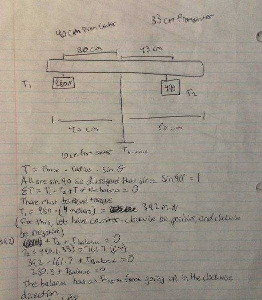

I did a lab and am trying to find the mass of a meter stick. Our fulcrum was at the 60cm mark at the meter stick. A 100 g mass was placed 30 cm away from the fulcrum on the shorter side. A 50 g mass was placed 43 cm away from the fulcrum on the longer side. How do I find the mass of the meter stick?
Torque=rfsintheta
Not sure how to calculate this

Okay, please show your work.
Well firstly, the masses are in grams not kilograms! So the weight is not 980 and 490 Newtons, it is 0.98 and 0.49 Newtons. I would suggest not even calculating the weights, just call it 0.1g and 0.05g because the g ends up canceling so why not save a bit of effort.
(It is very often good to not plug in numbers till the end!)
Anyway, you wrote "980*0.4" and "490*0.33" and I have no idea where you got these numbers from...
What is the torque due to the 100g mass? What is the torque due to the 50g mass?

I got the .4m and .33m because those are the distances from the center of gravity of the meter stick.
The torque of the 100g would be .4m X .98 Newtons = .392 Nm.
The torque of the 50g would be .33m X .49 Newtons = .1617 Nm.
Right? Am I supposed to use the distances form fulcrum of the center of gravity?
If this is correct I would do .392Nm - .1617Nm = .2303Nm which would be the torque of the meter stick. And since it is .1 meters away from center of gravity wouldn't that make the meter stick .2303 kg?

The fulcrum
So should I find the torque of each mass by doing .3m X .98N = .294Nm and .43m X .49N = .2107Nm? Then would I subtract those to find the torque of the fulcrum

.0833Nm then how do I find the mass of the meter stick from this number
That is the torque due to gravity, right? Which equals...?

Would it be torque of mass 1 + torque of mass 2 + torque of gravity = 0
Yes. Now what is the value of these torques? Specifically, the torque from gravity... At what distance does the force of gravity act from the fulcrum?
Put it all into your torque equation.

Torque 1 = .294Nm
Torque 2 = .2107Nm
-.294 + .2107 + torque of gravity = 0
The force of gravity acts .1m away from the fulcrum
OK but can you put those words into the equation...? Call the mass of the meter stick "m"
I'm not sure how to put it in the equation..would it be torque of gravity / .1m?

9.8 X mass

Torque = rfsintheta but in this problem sintheta=1. I found the torque of gravity to be .0833 from that equation if that's cprrect? So I have .0833 = .1 X f. Solve for f and get f = .833 N. I divide this number by 9.8 to get
  • #32
.085 kg but this can't be right what am I doing wrong?

Good. 85 grams. The actual weight was 97 grams? You're not doing anything wrong. You said it was a lab, right? So you actually measured these distances? That can account for the error.
Look at it like this... If the 50g mass was actually at 42.5 cm and the 100g mass was actually at 30.5 cm, then you would get an answer of 92.5 grams. (Not to mention if the fulcrum is not exactly at 60 cm! That's probably where the error really comes from!)
