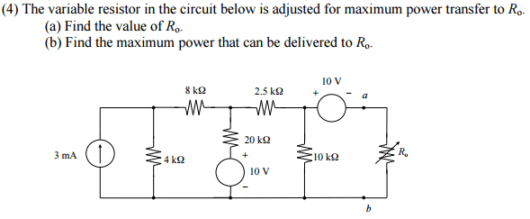

In summary, the answer key for this problem states that part (a) has already been solved and determined to be 5kΩ. However, the answer key does not provide any explanation or workings on how the maximum power of 957 µW for Ro was reached. The student attempted to find the power by using Mesh Current Analysis and found the current to be 0.7333 mA, but this resulted in a power of 0.00269 W, which is far from the given answer. The student is unsure if using Mesh Current is the correct method or if another circuit analysis method should be used.
jinger
Part (a) has already been solved and determined to be 5kΩ, which has been confirmed by the answer key.
The answer key also states that the maximum power able to be delivered to Ro is 957 µW, but doesn't give any workings or explanations on how to reach this answer.
P = I * V
V = I * R
P = I^2 * R

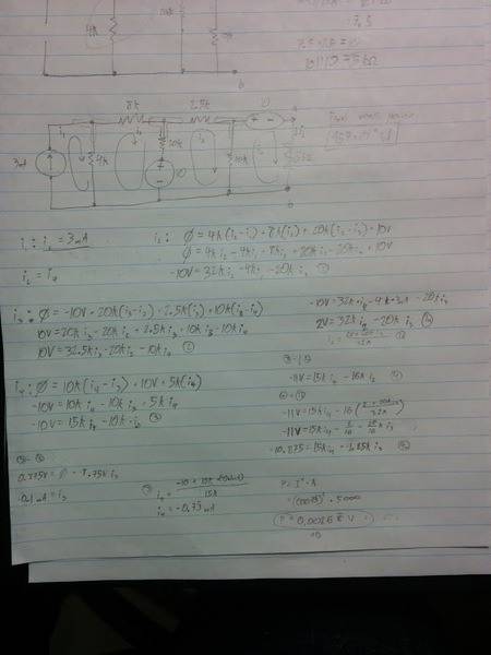

I've attempted to find the power by finding the current across Ro and using that and the value for Ro to find the power. I found the current to be 0.7333 mA using Mesh Current Analysis, but this gives a power of 0.00269 W, which is far from the answer.
My workings are shown in the image below.
Sorry if anything is difficult to pick out.
Am I correct in thinking that using Mesh Current to find the current across Ro will work to find the power, or should another circuit analysis method be used?

Yes, you can use the Mesh Current method to find the current across Ro, or you can replace the circuit by its Thevenin equivalent.
Your handwriting is impossible to read, type in your working. Your result is wrong.
