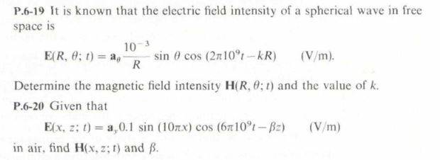

Hello
As you see the answers of 19 and 20 problems we should try to find K or B(wave number) in wave equation.both of equations are in air space but we can't use K=(2*pi*f)/V ( F=frequency & 2*pi*f=omega , V= light velocity 3*10^8) for both of them.
could you tell me why we can't use the K=(2*pi*f)/V for both of them in air space?does it have any condition & reason that we should check them before solve the problems?
Any help appreciated
Both of what? Both problems?
Where does that relation come from?
Thank you dear simon for you replay
My meaning is why in problem (6-19) should we use k=w/c but in problem(6-20) we should not?
your meaning is K=w/c?
I mean - what physical property of the wave does k represent.
The second case is in a medium - what is different about EM waves traveling in a medium compared with a vacuum?
hint: if you took k=w/c for the second case, you could not use c=3x10^8m/s.
